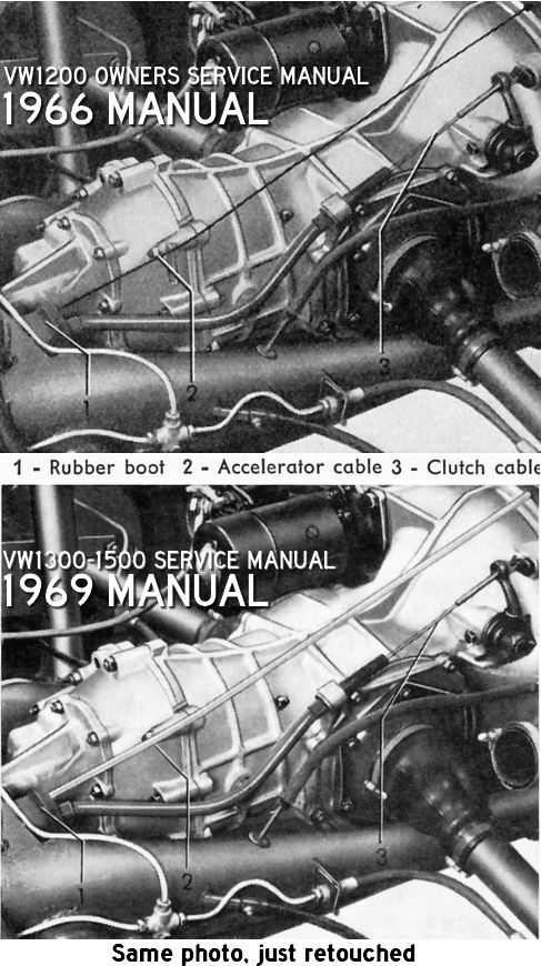

Posts: 71868
PostPosted: Fri Dec 17, 2010 6:05 pm    Post subject: Reply with quote
Linda Grunthaner wrote:
OK I give up what is a bowden tube?
Searches...
Gallery search
http://www.thesamba.com/vw/forum/album_search.php?search_keywords=bowden+tube
Image that came up right away:
http://www.thesamba.com/vw/forum/album_page.php?pic_id=687459
It's also in the dictionary on here:
http://www.thesamba.com/vw/archives/dic/b.php
(Actually found that via Google as I forgot it was on here, a bunch more data came up on Google, hint, hint)
