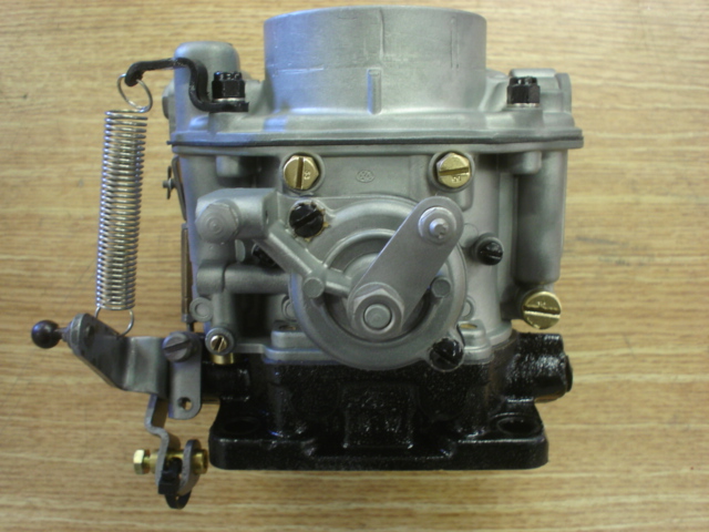

I've noticed a few different versions of these manifolds but never really any explanation about them.
First off, Any Bugspray will fit a Zenith maifold and vice versa correct?
Second, I've seen some manifolds where the base is angled to the side, I'd imagine this is for use with an alternator as the ones that sit straight are for generators?
Third and lastly, Race Trim and another company which the name seems to slip my mind have made great looking manifolds for them. Can these be used with either an alt or gen?
Thanks!

Bugspray and 32NDIX do use a slightly different bolt pattern IIRC. The offset distance from the fan shroud is also different, and NDIX runs better with a plenum manifold and BS runs better with an isolated runner. I have both carbs and manifolds in the garage, maybe I'll pull them out and compare. I have a Zenith on a Deano plenum on my car and it runs great.

my manifold was advertised in the classys as a bugspray. the zenith fits fine.
it has isolated runners.

Yes, my bad, I compared the flanges and they are the same. I "think" the offset to the fan shroud may be different, as well as isolated/plenum. Sorry, CRS sets in. The manifolds I have at the shop have elongated bolt holes for some other carb, too, but I don't know what it is. I do have a couple of crappy manifolds I could sell you but they are goobered up where the heat tubes are either cut off (bad!) or cut off and welded back on, maybe not in the correct position. There should be nice clean manifolds in the classifieds.

The zeniths Run great but have some fit issues they set to the left and a new throttle tube and hole need to be drilled..
I have found the run well on both isolated and Plentm manifolds. jetting changes some.
Zeniths are better then the Holley..

I pretty sure you can get the Zenith, Bug Spray and DCNF carb to fit the same manifold. Many of the steel tubular ones had slotted bolt holes.
My vote is for the Zenith.
