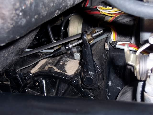

Check this out: Harbor freight special....called a masonry anchor. I call it a slick clutch cable shortener.

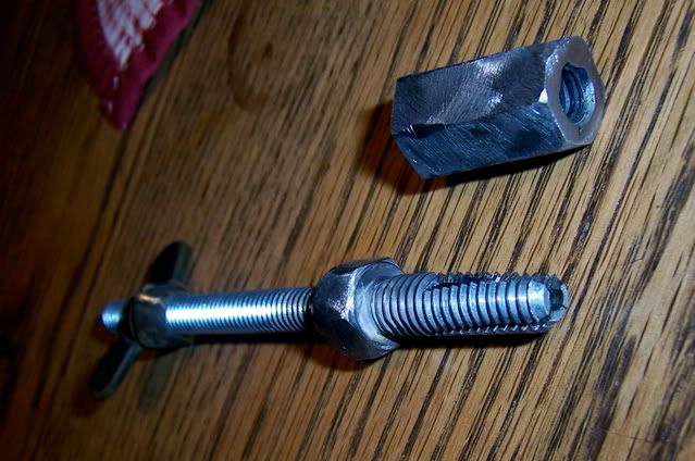

WOW, Here is something I made two weeks ago. It worked until I took it apart to shorten the cable a little more. At that time part of the bolt broke off. I hadn't gotten around to making try two which was going to use a little larger bolt. Anyways thanks for saving me the hastle. Very Happy
It's amazing that three people here are thinking almost the exact same thing.

Oh yea I just got back from Harbor Freight, but I bought this one instead. It appears to be pretty nice and fits the cable well.
Item #96896

PostPosted: Wed Apr 09, 2008 6:10 pm    Post subject: Reply with quote
Done deal. So far so good. Need to figure out a better adjustment nut arrangement.
Be sure to keep us updated if you have any issues with the "adjuster". It sure looks good.
Helicoil the stock wing nut to the same size as the rod...HMMMMM Rolling Eyes Rolling Eyes

Tom, I would think that shortening them 14 1/4" or 14 1/2" whatever the official chassis shortening measurement is would be the correct length. Of course then you would have to contend with those with other buggies like Empi 12"? I guess what I am saying is that however much the chassis is shortened is how much shorter the cables should be.
Now the Berrien is a different story and may all be somewhat different. I had to shorten my bowden tube to make it all work out.
Good Idea Murzi, I will wait until I get another/spare adjuster wing nut to experiment. I'm not sure that the hole isn't too big for the correct size Helicoil, but I'm sure something out there will work.
I know Low Cash has the shortened clutch cables, but the way they are shortened won't work on my chassis. When the clutch pedal is all the way up the cable end contacts the front of the tube. I think the mounting bracket is too close on mine to cut some off. However I have a friend with a Berrien chassis also and he uses one.
