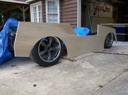

Hey guys, as my first post I thought I would show some early pics of my latest project. I bought a Kelmark (still have it) and while building the chassis I found a picture of a VW Country Buggy. That was it, I had to build one! I have some photos of the chassis build but this is one picturing one of the sides in mock up that I cut out this past weekend. After all the body panels are built I'll fiberglass resin them and then reassemble. More pics as I go!

The picture of the Evil Ben built car was my inspiration. However, I plan on improving on the original body lines a bit. I have lowered the rockers, shortened the stepover, exaggerated the rake of the hood slightly and a few other mods. Obviously the car will be about 5 inches wider than a stocker as well to house the big wheels.
Mine will have a full length top with approximately 12" of overall height. The color is late VW Cyber Green with off white accents.

Are there any curved panels on a Country Buggy or is everything flat? It seems to me that a set of detailed plans & materials list for how to build one from wood could have some value. Think of all the legwork and time you are saving another prospective builder.

I will have most of the body panels cut and templated this weekend (will post some pics). Giving them or selling them to someone else doesn't really interest me at this point. Keeping the exclusivity....well exclusive!

You mentioned you were going to "fiberglass resin them and then reassemble".
If you think that it will hold up or even last you will have done all of your work for nothing. You must Fiberglass them, inside and out or will not hold up well. Even then you'll not be happy those results.
You will be happier using your plywod as a Buck or a "Male Mold" and pull your panels off of them, complete with the corner edges turned...
Even constructing it out of foam sheet, such as sign foam, yeah its expensive say $75 or so for a 3/4 sheet, but its rigid, water proof and when glassed on both side it will ultra strong and rigid.
Unless your using marine grade ply and epoxy resin and glass your work won't last as long as you thing. Polyester will seperate from plywood on the weathers heating and cooling cycles and unless you either construct a nice rigid frame work inside or glass both sides equally or else your warpage will be a nightmare.
Theres alot more to making this work then just coating plywood. Above all Glass is were your strength will be.

How about making a wood body and then coat it with tongue oil or some other finishing process. What do owners of woody wagons do?

You could finish off both sides of the plywood for a plug for both sides to make fiberglass molds A couple pieces of molding to make the ridges down the sides. Looks good.
