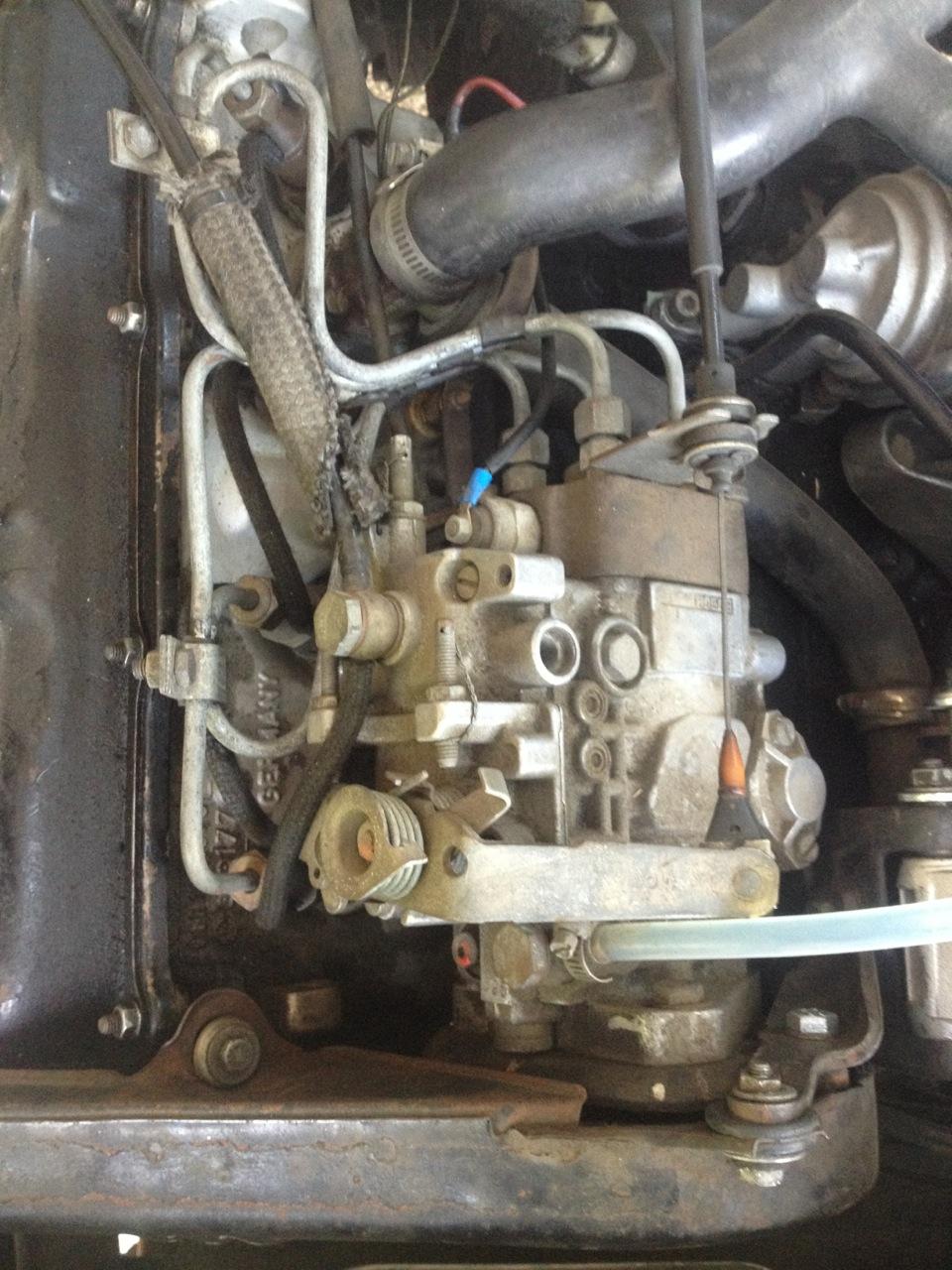

Posted: Sat Jan 04, 2014 12:31 pm Post subject: |
Well, I *think* I have a bad glow-plug issue. My van is unable to start even when 50 sunny Cali winter day
It showed signs of a failing alternator not charging the battery which has been replaced. The battery voltage looks fine. The starter sounds strong in its trying to crank the engine over. The glow lights go on and then off within 30-40secs. I see fuel hitting the clear fuel-line, and I also smell fuel/see white smoke coming out of the exhaust at times.
The van was running fine two months back and then I did some work while it sat. This New Years I went to a camp site and had to get a jump that morning which I thought odd, because the battery was fine voltage, but it got us started and I shrugged it off.
Later on the way back from the camp site it just kept trying to crank over, but nothing happened even after 30-40secs of good solid cranking.
I noticed my glow-plug relay, looks a bit hack-jobbed, even though properly wired. The last known receipt from previous owner states the glow-plugs were replaced in 2008.
I connected a positive lead to the fuse-red-wire and touched the negative post to the fourth glow plug and saw 40a roughly. I'm not *exactly* sure if I put it on the right spot, but here is a photo of the 4th plug and the red-wire I mention.
Also, reading before, the metal pipes were mentioned required to get access to the glow-plugs for removal. Is there any further instructions on how to access the glow-plugs or another topic on it? I have been running into not the best of luck to figure this procedure out and what it entails.
Thanks for any input! _________________ -Will
1982 Westfalia mTDI (50deg) aka Betsy Bertha
http://www.tdivanagons.com |

Posted: Sat Jan 04, 2014 2:14 pm Post subject: |
You can do them with ratchet spanners but if we are doing them at work we don't mess about,injector lines off and a couple of injectors out, dead easy then, much quicker than messing about down the back of the pump. _________________

Posted: Sat Jan 04, 2014 2:33 pm Post subject: |
So, removing the injector lines / injectors should give me enough clearance?
Is there any benefit for removing the whole injector pump via the three bolts going around it and the two allen bolts towards the back? _________________ -Will

Posted: Sat Jan 04, 2014 2:54 pm Post subject: |
You don't need to take the pump off.
17mm spanner for the injector lines.
27mm KCA type injector socket.
8mm ratchet spanner.
12mm ratchet spanner.
Remember you'll need some new flame traps/injector sealing washers as they are single use and need to be replaced if you remove an injector.
Youll get the 2 not covered by the pump with normal socketry. _________________

Posted: Sat Jan 04, 2014 6:33 pm Post subject: |
I have most of that except the 27mm which I ordered today.
Do you have an idea where I could obtain the flame traps/injector seal washers?
Any other advice on removing the injector plugs/bars for access to the glow-plugs?

Posted: Sat Jan 04, 2014 11:21 pm Post subject: |
| I would not recommend removing the injectors in order to access the glow plugs. The injectors aren't in the way of the glow plugs, you would need to replace the injector heat shields (single-use) and you run the risk of cracking the injector boss if you do not do it correctly which would then require you to replace the cylinder head... If you feel you must remove injectors, then be sure to orient the breaker bar so that you are pushing toward the head not pulling away as the puts less stress on the injector boss. Also, do a a 1/4 turn out, 1/8 turn in, 1/4 turn out, 1/8 turn in, etc... If the injectors have not been removed in a long time then the crud on the threads can ball up and also pop the injector boss. |

Posted: Sun Jan 05, 2014 10:54 am Post subject: |
Andrew,
Thanks for the update, I'm just trying to figure it all out and for whatever reason the Injector lines aren't too covered in the Bentley.
The injector lines you speak of are the metal tubes from the injector correct? To remove those, do I muse unbolt the end of the metal lines to move it out of the way?

Posted: Sun Jan 05, 2014 12:34 pm Post subject: |
Okay, I have the injector lines removed and I can see the glow-plugs better.
I've been trying to remove the 8mm nuts off of the glow-plugs, but the angle hasn't been too successful using a standard 8mm wrench and smaller 8mm socket.
Any suggestions or tool you think I should look into or is it an act of patience and little turns
Thanks! _________________ -Will
