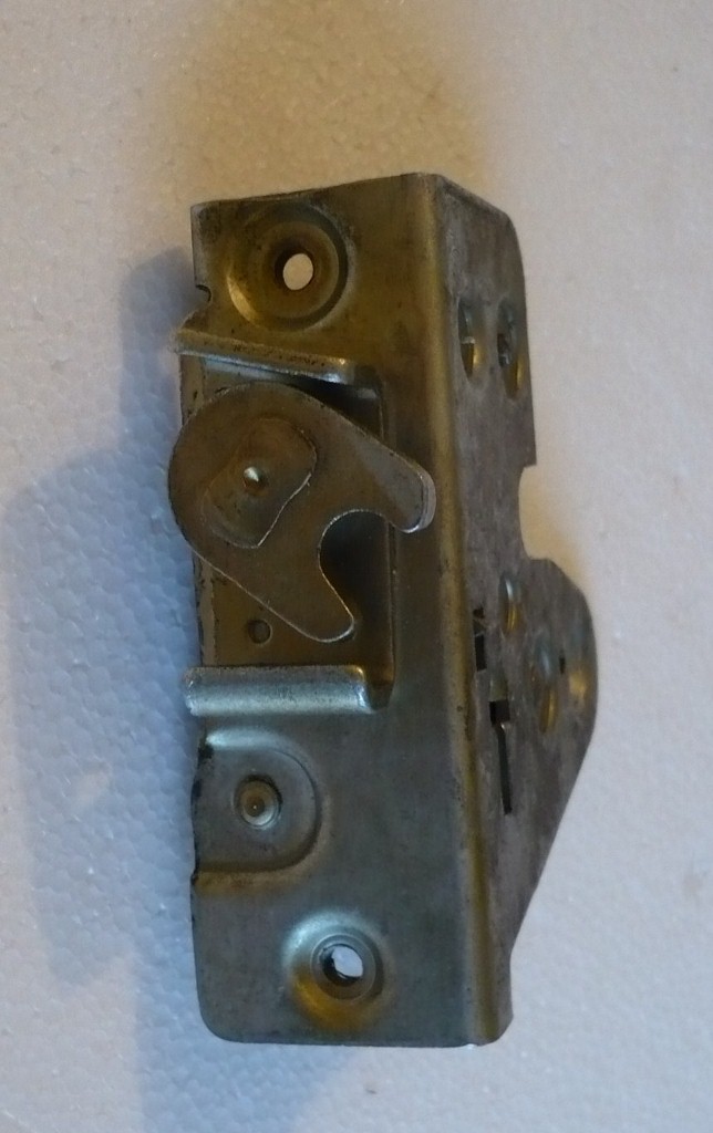

PostPosted: Sun Jun 05, 2011 5:09 am    Post subject: Reply with quote
ok, so this is the door i have
the ice pic handle i have will not fit, as it has a square base, and there is a round/oval hole in the door.
I have no mechanism or rod other than this (which is an early striker/mechanism)
now...if i got a late mechanism/striker and rod (correct for the door) would this fit with my handle (if i enlarged the hole in the door skin)
OR can you get a later ice pick handle for this type of door? I assume you can by the fact there is no other mounting holes in the door skin.
Many thanks
Clara Premium Member
Joined: June 14, 2003
Posts: 12650
Clara is offline
PostPosted: Sun Jun 05, 2011 8:32 am    Post subject: Reply with quote
Clara wrote:
The early door mechanisms do not fit the later doors (& vice versa)
The ice pick handles don't fit the later doors, nor would they work with the later door mechanisms.While you could theoretically fab up a striker plate to let the later door work with the later door mechanism, the easiest thing to do would be to find the right door for your bus, and sell the later one you have.
If you hack your door to make it work, it will still be something that needs to be replaced with the right door, and then it will be harder to sell the hacked door.
FWIW, VW did make a striker plate that goes on the door jamb, letting you used a icepick door on a 63 1/2 through 65/66? bus. You would want the oppposite of that, which I haven't ever seen.
You have the one part of the 55-60 door mechanism. The door is wrong though.

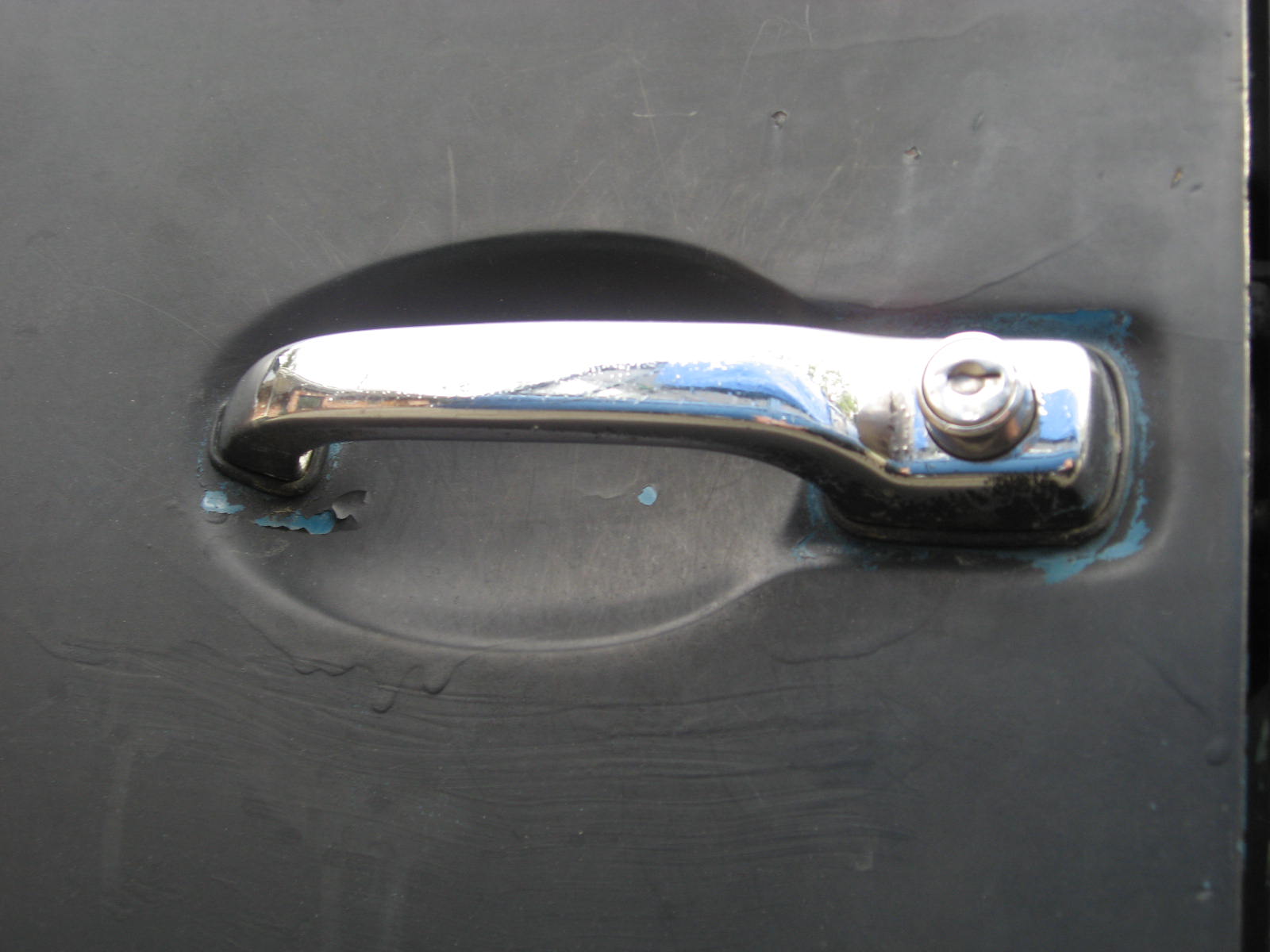

FWIW, there are two, well three kinds of icepick doors.
barndoor:
3/55 through VIN 705 xxx, larger finger recess:
the 61-12/63 kind has an indent where the door handle base goes.
64-67: (there are variations in push button doors as well, but general idea)
the door mechanism is completely different from icepick to push button.
icepick door mechanism:
push button back part of door mechanism (one of two kinds):
the door mechanism for 55-60 is different than 61-63, see parts list for p/n
the door handle base is also different 55-60 than 61-63.
The left mechanism is different than the right, pasenger locks from inside, drivers doesn't. You don't want to accidently lock the bus from the inside on the drivers side, cause then you can't open it from the outside. It is important to use a driver side mechanism on the drivers side, though they will fit the other way.
hope that helps
