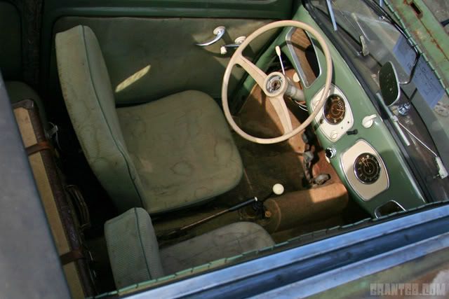

Could someone tell me if my seats are correct for my '51, or if they're infact from an Oval.
The door cards have got the original cloth underneith the green. But the seats are bear under the green covers.

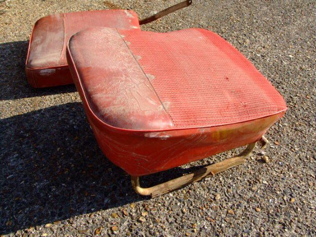

This is what they were like then I got the car, before I stripped the red covers off.
Click to view image

PostPosted: Tue Jan 13, 2009 7:55 am    Post subject: Reply with quote
Those look like oval seats. The backrests should be arched, yours are flat

PostPosted: Tue Jan 13, 2009 8:02 am    Post subject: Reply with quote
Ah, ok. Thanks Very Happy
Is that seat base different as well or is it just the backrests?
Also, are the back seats different split to Oval?
Thanks, Rich.

PostPosted: Tue Jan 13, 2009 10:20 am    Post subject: Reply with quote
I thought the entire rear seat frame up till 1955 were the same.
The front seat bases were he same till 1955
The front seat backrest 1950-52 had a more pronounced curve.
The front seat backrest 1953-55 were more upright
Not sure on the spring assemblies for the seats though. But I've seen early seat springs with very large circular coils

PostPosted: Tue Jan 13, 2009 10:38 am    Post subject: Reply with quote
Those look like cloth seats for a 54-55 iceland green oval. Not sure from here, but looks close... Don't throw these away, I'm sure some would be interested here. http://www.thesamba.com/vw/forum/viewtopic.php?t=3...p;start=20

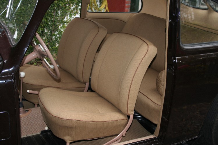

PostPosted: Wed Jan 21, 2009 2:37 pm    Post subject: Reply with quote
You should have the curved backrest as shown on pic
[/img]

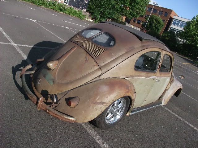

Pic by CrazyDaze
Click to view image

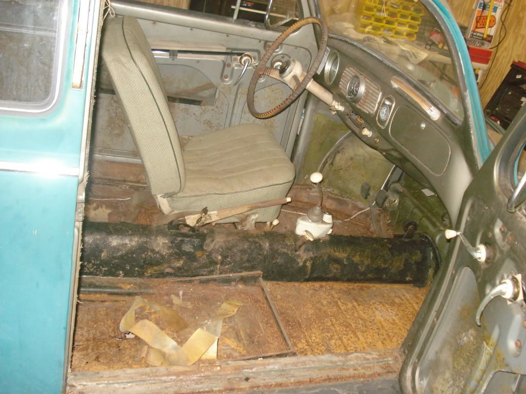

PostPosted: Sat Jan 24, 2009 3:06 am    Post subject: Re: Split seats Reply with quote
petrol punk wrote:
My Polar Silver '56 has seats that look EXACTLY like those. Are your frames a tannish beige?[/quote]
I think the stitching looks slightly different on the base. Can't remember the frame color, will look later.
Click to view image
