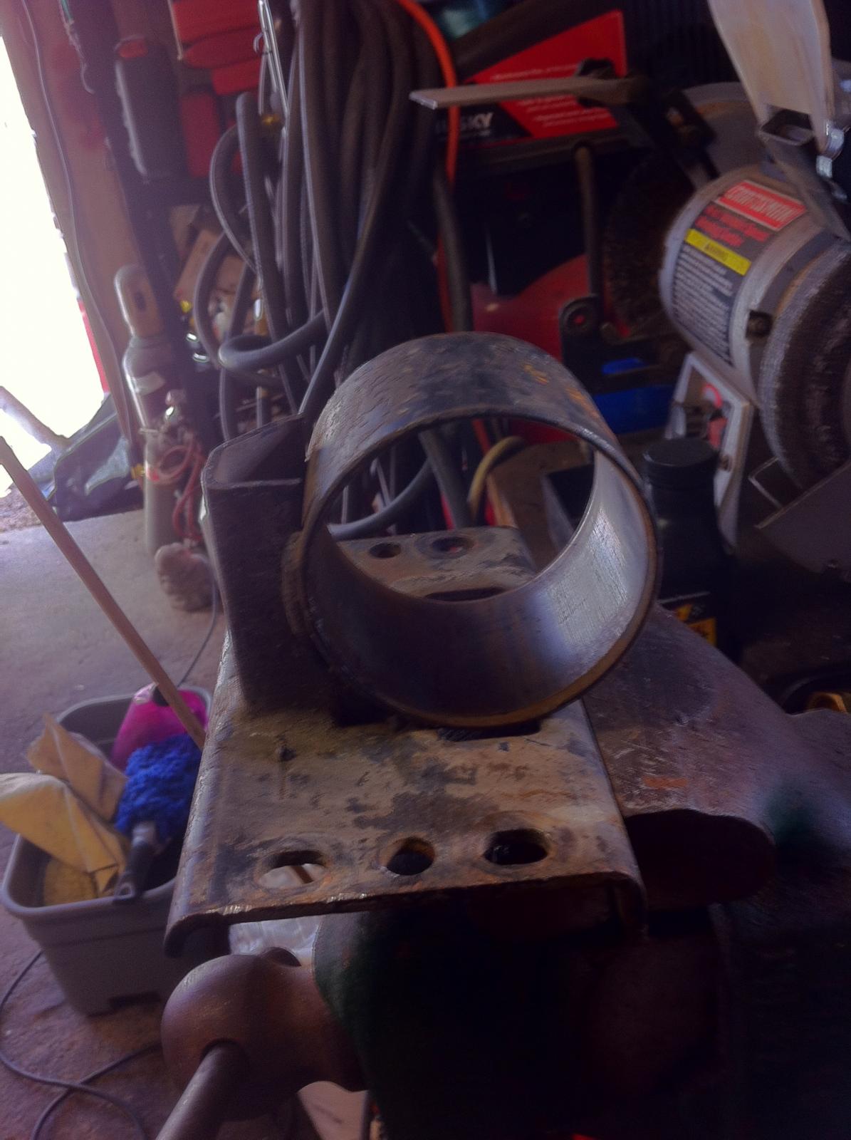

PostPosted: Thu Jul 25, 2013 8:58 pm    Post subject: Reply with quote
Using the search for Powerflex trans mount installs, I found my old thread. Sorry about the above pic loss. 'pooter crash.
The aftermarket mount is doing fine.
I recently received the smaller Powerflex trans mount bushing kit from T3. Today I removed the old rubber from the OE mount that I saved. Tomorrow I'll pick up some CV2 grease and install the new bushings.
