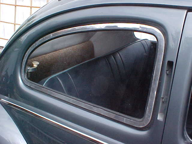

Has anyone come across new early pop-out frames, just the frame, I have everything else.
Thanks.

Hey, I'd like to put pop outs in my '57. It didn't have them when I bought it and I don't know if all the cars were set up for them from the factory, or no? I really don't want to buy a set and then discover they can't be installed. Anyone know for sure? Thanks, Mel.

Your 57 won't be predrilled for the hinge and latch holes but it is obvious where to drill once the window (with seal) has been pressed into the opening.

On the topic of early frames, what years to they change?
RareAir has the smooth aluminum (?) frames which look GREAT! But what year did that style end and get replaced with the ones used through '64? I would like to put the proper ones into my '56 if I can find a pair.
1950-52 smooth frame, no seal ($4000+)
1953-55 smooth frame, w/ seal ($4000+)
1956-64 ribbed frame ($200-$300)
1965-76 ribbed frame ($25-100)
What sucks about the popouts when used on 1956-57 Beetles, is that the Sekurit logos on the glass is small. Original glass on Pre '57 VWs have a large logo so they won't match 100%. Crying or Very sad But the 1950-52 & 1953-55 sets do have the large Sekurit logos Very Happy
