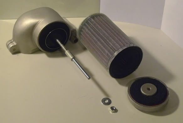

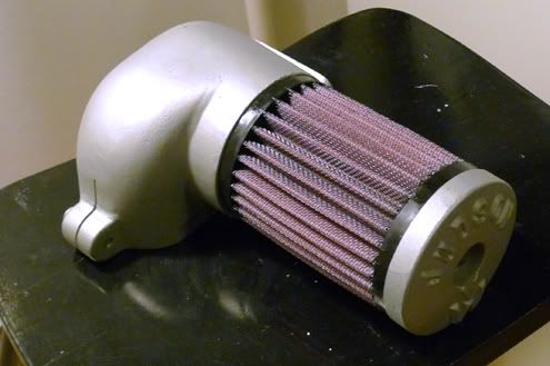

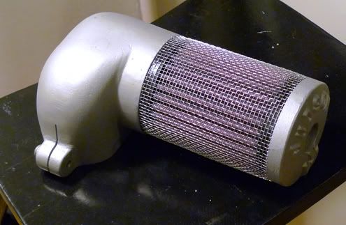

In the meantime I'm trying to improve the air filter. Special vanes are not an improvement if dust can enter the blower. There'd be the same grinding friction eating away the rotor and chamber.
This one is a K&N. Not the best in filtration, but "adequate", at least it's a filter. The rubber ends seem to seal well. It'll look different - as it ought to. Form follows function.
John TC
Joined: August 14, 2010
Posts: 117
Location: Jersey UK
John TC is offline
PostPosted: Wed Jan 18, 2012 11:37 pm    Post subject: Reply with quote
That looks like it will do the job
what K&N part munber is it?
skyto
Joined: November 24, 2003
Posts: 177
Location: Finland
skyto is offline
PostPosted: Thu Jan 19, 2012 1:43 am    Post subject: Reply with quote
RU-0400, 3''d x 4''h, free shipping from/within UK, search Ebay.co.uk for the vendor. The threaded bar holding the endcap will have to be extended with anything taller than 4''.
I cut the rubber flange off, widened the hole to 52mm and cut the rubber top for the endcap boss to fit in the center.
Here's the final version, RU-0410. 5'' tall. I decided to extend the stud. Original threads were alien technology, like m6 with 1.17mm pitch. So I just cut it and made M6 threads at the other end.
With time, I suspect the filter could lose it's original length and a gap might appear at the ends, especially on bumpy dirt roads. I didn't want to use any sealants or glue, instead I made a collar for the intake end (a modified sprinkler collar) with a foam filter donut insert (cutout of a pipercross foam sheet). The collar has the same diameter as the carburetor top, shouldn't be too restrictive. The filter cap was stuffed likewise.
There are two K&N formulas to calculate the filter size, search internet for these
- in relation to effective filtering area, engine size and max rpm
- flow: engine CFM and CFM of filter
Results were the same using both formulas. Boost factor for 6PSI would be 1.4 for the effective filtering area.
Filter height calculations: 3'' filter diameter, shape=round straight, including .75'' for rubber end caps, max rpm 4500, displacement 73CID (1200cc):
Without boost: minimum height 2.4'', dusty conditions 3.3'', severe dust 4.1''
With 6PSI boost: minimum height 3.1'', dusty conditions 4.3'', severe dust 5.5''
