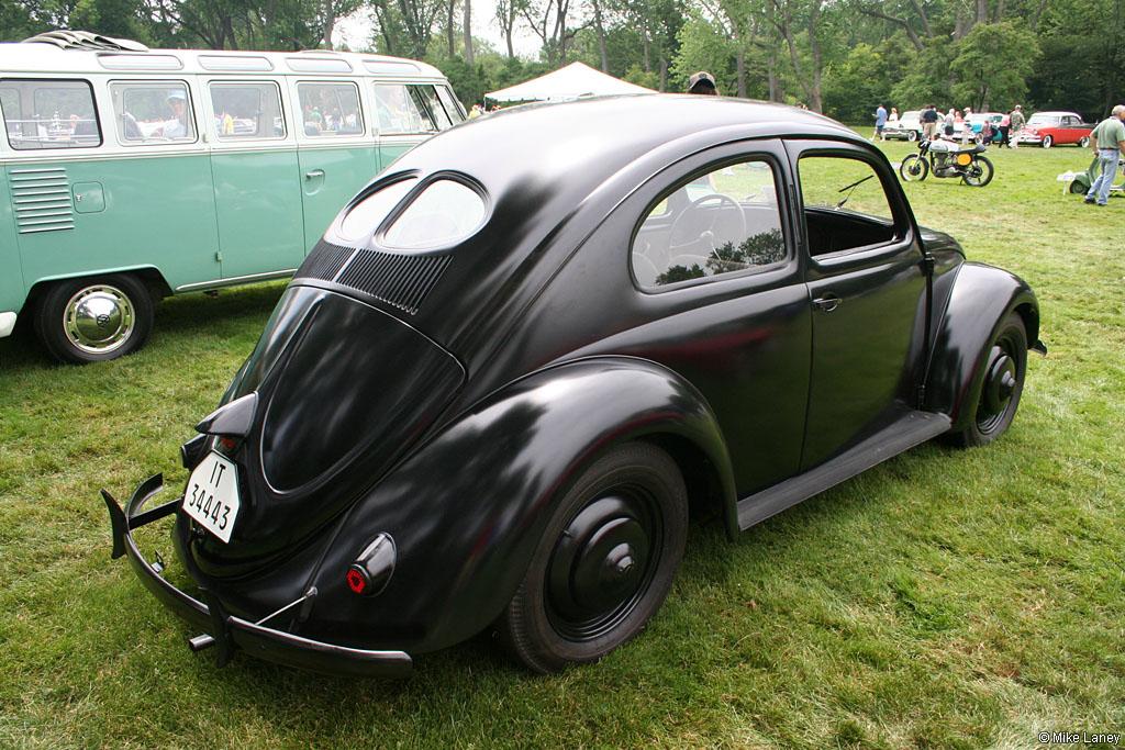

I got the info that one of the very rare real KdF type 60 is on auction at Hershey
http://www.thefinest.com/hershey-2016/1943-kdf-beetle
I had the occasion to inspect this car closely in HO 2005 when it had it´s first public appearance, freshly restored.
I am very curious at what price the auction will close. Such models (civil KdF beetles) practically never get publically offered.
Pic I took 2005 in HO:

Certainly one of the very, very few real type 60 that survived into our days.
I would dare to say, that there are maybe 10 restored and at the same time serious examples of this very type still on the globe (from about 600 civil beetles made from 1940-1945).
If I am saying "serious" I mean cars, that were born as a type 60 and that still retain their original body (with og and unspoiled front (ears/barrel tank) including the og VIN tag and stamped bodynr) on the og chassis, body and chassis with most of their og panels/bodyparts.
Not to mention all the special and rare KdF parts and features that are characteristic for those jewels. It is a huge task to restore such a car in a correct way.
There are many fakes and wannabes out there.

When Mac appeared in HO with his car Originalo has been there with his one as well.
I am not an true KDF expert but I´d say Macs was good but Originalos was better.
