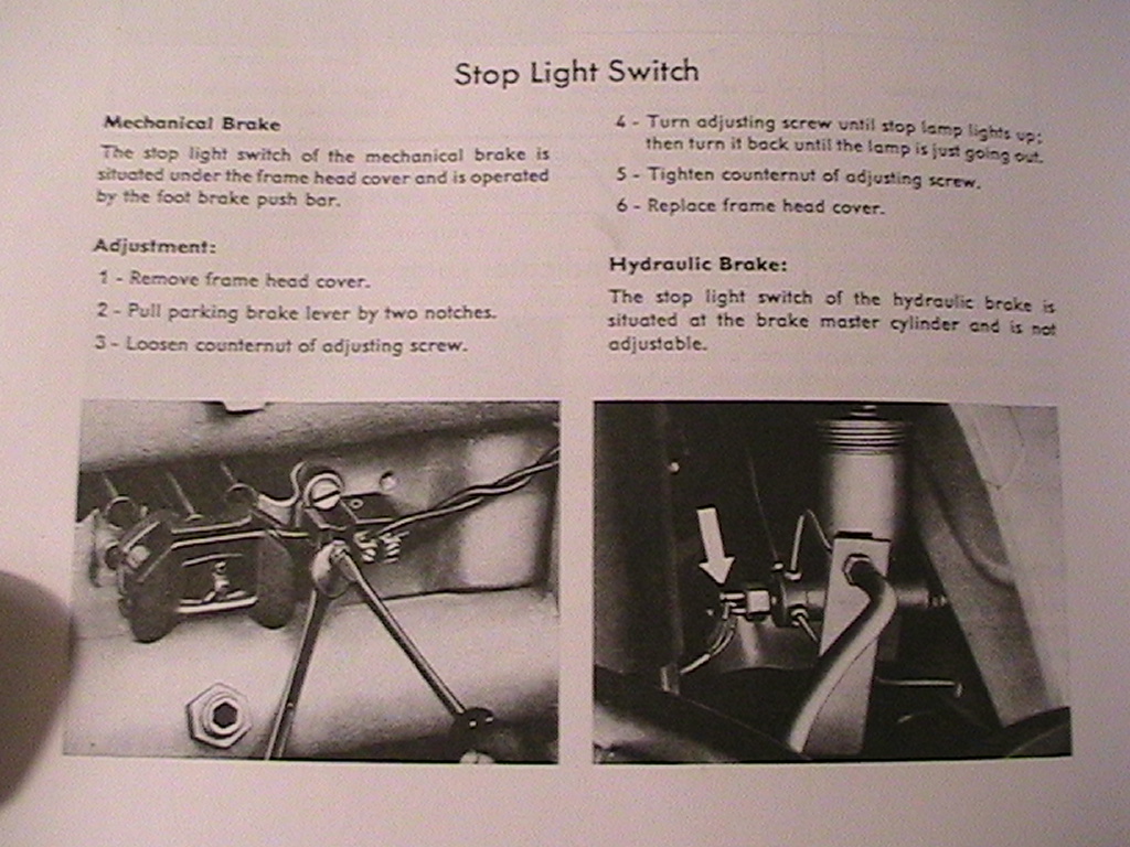

I just sent information from the VW Workshop Manual ....VW Passenger Cars 1952/54.... to a Samba Member who needed to know where to locate and adjust his Stop Light Switch, but I cannot post photos. I was hoping that someone could post a picture of page 6-4 of section E so he can better see what he needs to do. Confused
He has mechanical brakes...

Here you go...
Thanks to the Bentley folks!
