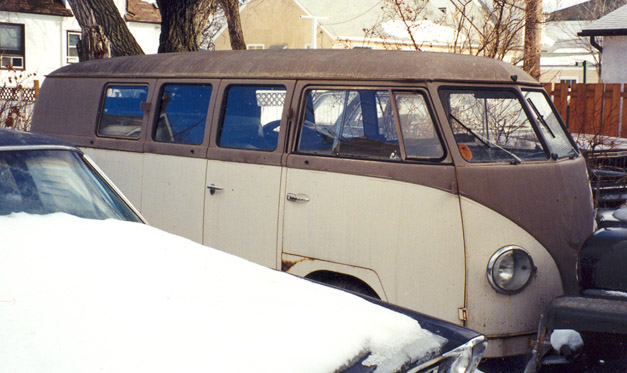

kintail
Joined: January 01, 2003
Posts: 789
Location: Canada
kintail is offline
PostPosted: Tue May 02, 2006 2:46 pm    Post subject: Reply with quote
You can just make out the original pinstriping.........
