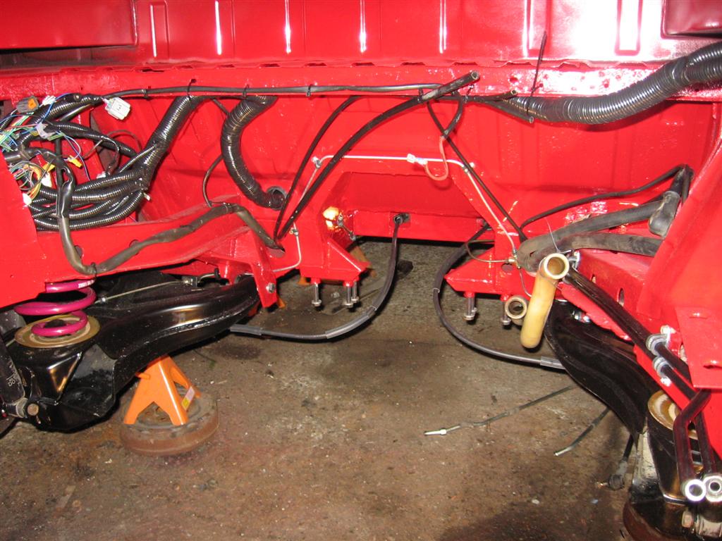

PostPosted: Thu Feb 03, 2011 3:29 pm    Post subject: Reply with quote
Smile
Here's what I am doing presently..............
Its a Porsche 915 5 spd, and there seem to be lots of room and easy to mount.
Len

PostPosted: Thu Feb 03, 2011 6:40 pm    Post subject: Reply with quote
BoxsterGT wrote:
Smile
There seem to be lots of room for this tranny.
Len
Smile
Very doable.
Thanks for the picture.
