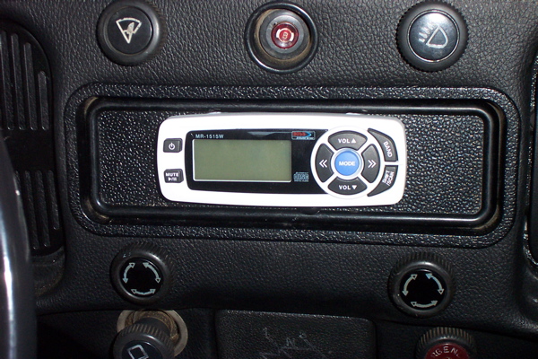

When I decided I didn't want to cut my dash or use the glove box, I used that block off plate and trim to do this:
Stereo is mounted in the trunk, I got radio and ipod inside.
John

is that just velcrowed or 3m taped to the block off Plate? is it a wireless remote for your stereo? I am not up on new stereo's, as i dont have a radio in any of my cars.
johneliot
Joined: August 29, 2005
Posts: 2195
Location: Chico, CA
johneliot is offline
PostPosted: Thu Dec 06, 2007 7:53 pm    Post subject: Reply with quote
That is a marine unit. It is a wired remote. Normally it is what you would use when you are in the water and it is attached around the swim platform. I like it because the head unit is made to withstand moisture. My trunk is sealed well, but it's nice to eliminate one variable. It is held in back by a piece of "C" channel. Two holes are drilled through the channel and long bolts are threaded through to the back of the unit. As you tighten the bolts it sucks the remote unit tight.
