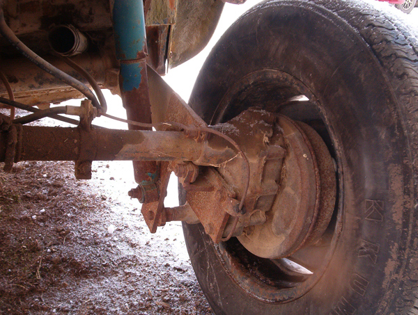

Well, as mine isn't driveable yet, the best I can do is post pics of mine. All work was done by the p.o. I'm still trying to figure out what I have exactly.
Left side
Right Side

The large nut would be the '63 to '67 so it looks like the small nut is stronger?
Your adapters look home made. My large nut tranny has similar adapters. If you have a 36MM nut on your drum you have small nuts, if they are 46MM you have large nuts.
Does anyone know if the internals of the trannies themselves are the same between the small nut and large nut? I am under the impression the redux boxes are differenr but the trannies are the same?
