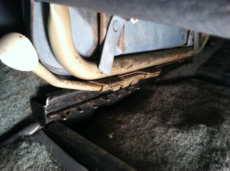

I also have a 66 and Im having trouble removing the front seats. The levers on both seats seemed to be jammed pretty good in the crease behind the teeth. Any tips on how to get them out? I havent had much luck.

PostPosted: Sun Feb 05, 2012 10:37 pm    Post subject: Reply with quote
How did it get in there? Think
Your teeth aren't even locked in the spots.
you need to tug a bit harder.

Thats what I would like to know. There jammed in there really good. I just purchase the car a couple of weeks ago and both seats were already like that. I've been trying to remove the seats so that I can pull the carpet out to clean any rust and battery acid.

I had the same problem with mine a few days ago. Use a rubber mallet and alternate tapping on each side from the rear until it slides free. I had a 69 that was rusted to hell and back and it was the only way I could get it free.

PostPosted: Fri Mar 16, 2012 12:00 am    Post subject: Reply with quote
Try positioning the seat in the most forward position that the teeth will catch the rail stops. I suppose it may be possible for someone to cut and modify a seat frame if that doesn't work.
