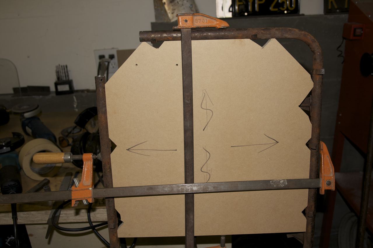

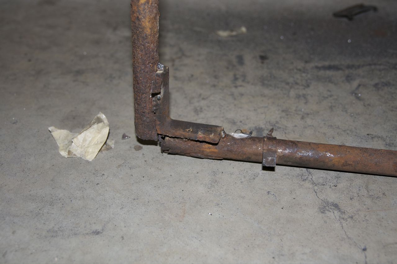

bringing this thread back for a progress report. Today I tackled repairing the seat base frame. Here's what I had to fix:
I had already cut the tab end off of this existing seat which was in good shape. If you remove it surgically it has a tube attached to it that is the ID of the seat frame tubing, so you just hammer it into you're new tubing and tack it in a few places. I cut some more tubing from the afore mentioned bay window seat frame and fabricated new corners. Make them long so you can cut them in to fit. Here's what I ended up with:
I then cut out the offending section back to good (ok, "decent") metal. I used a piece of MDF as a jig to clamp into the frame to keep everything lined up. Only cut and repair one corner at a time so that everything goes back together in the same orientation:
Now, my epiphany for the day. While walking by the garbage can a couple days ago I saw the broken tie rod I had removed a while back. Hmmm. That tube looks like the right OD for the seat frame ID. Is it? No. But it's close. I took 4 one inch sections and turned them down a little to fit in the seat frame tubing. This allowed for lots of flexibility when cutting in the new pieces. I plug welded these in through some holes I drilled in the seat frame tubing.
finally I fit the new sections in, and making sure everything was straight I welded in the new parts and ground them down flush. So, a few hours work but I didn't need to buy a new seat! Here's the finished product:
