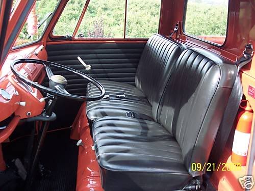

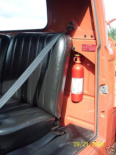

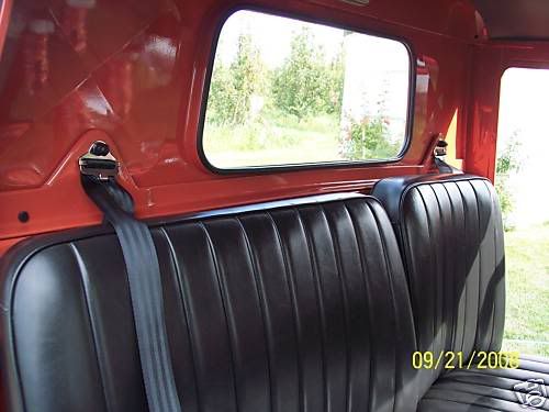

This single cab just sold on ebay I thing it was a 64 and have never seen this setup?

Confused That's odd. It looks like it could be factory, but given all the nice shiny paint everywhere I'm guessing a custom job. Still, I think those mounting points are way too low. If the upper mount is anywhere below the level of your shoulder in an impact get ready for spinal compression.
Not factory and very scary looking. Like you said, time for spinal compression.

I installed 3-point retractable belts in my '55 Ford F-100 pickemup truck so it can be done but those there are just way too low! Shocked

You guys ever see the stock mounting points for the shoulder belt on a late Ghia? The mounts in that SC are sky-high in comparison.

That is neat but I wonder if that metal would bend under impact?
