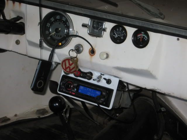

I built a little metal bracket to support the unit under the dash since I didn't want to cut the dash up.
I made it from a piece of angle I had laying around and incorporated my switches into it also.
My MP3 player plugs into the front of the head unit through the front aux. port.

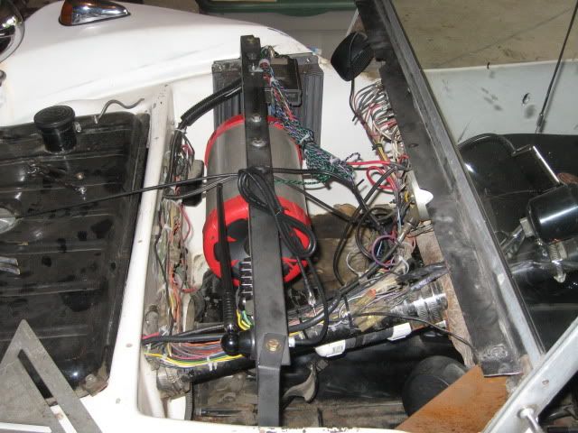

I spent less than $40 on my setup (small amp, existing MP3 player, free surround-sound speakers, and misc connectors) and it plays great. I can hear it with our without the top on (not concert hall quality). Just another idea. Lots of picts here:
