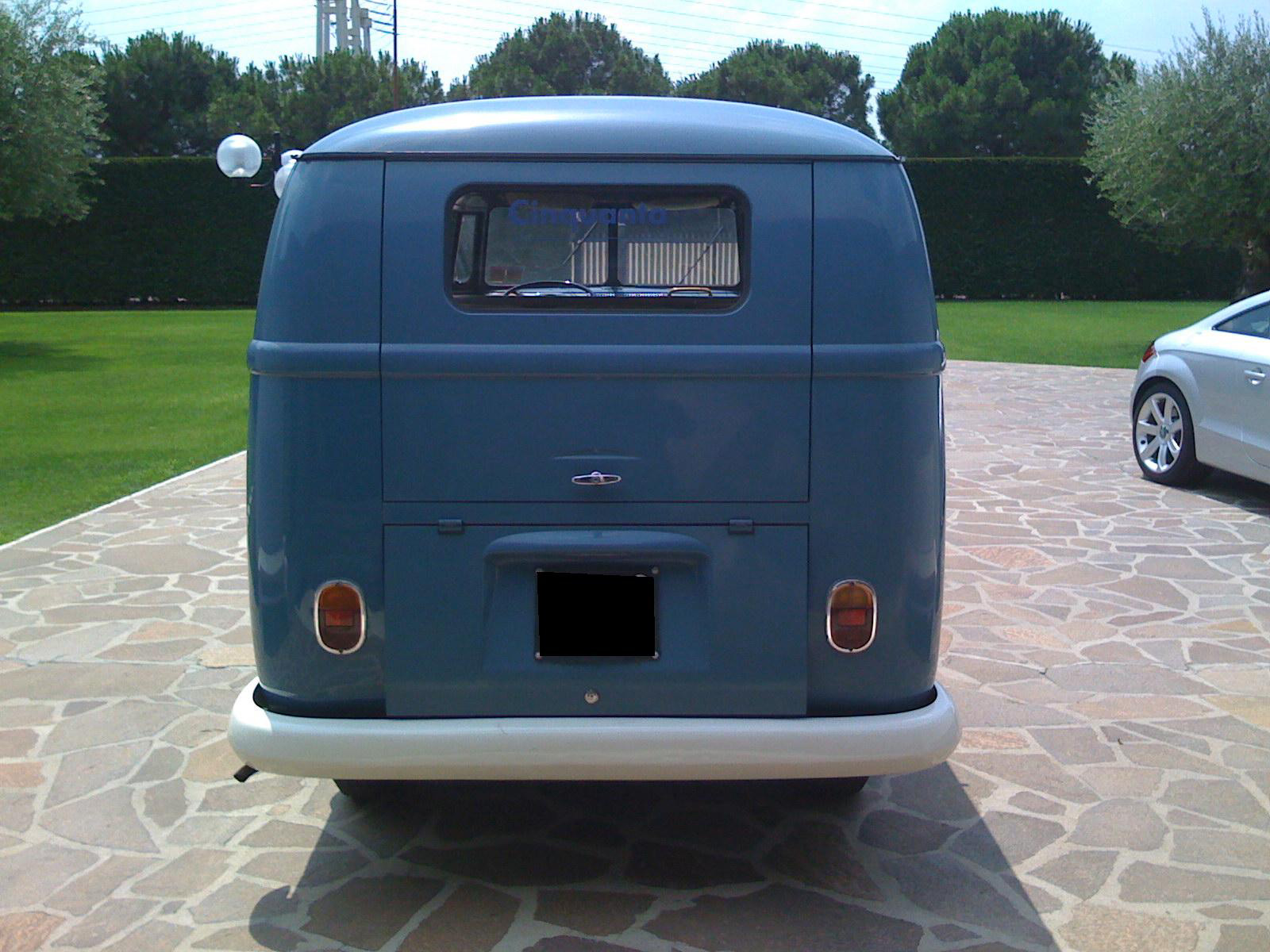

Anyways, I need to replace the area where my tail lights would be on a 62, bigger one's have been cut in, looking for some measurements as to location. Maybe from belt line down and from deck lid over.

thanks for the reply, but I have a 62 Smile
needed for these tail lights.
borrowed pic from gallery, thanks.

Cool, thanks Jeremy, I think if you measured from the top of the deck lid/engine compartment down to the top of light opening that should be the same, then from side of compartment to side of opening it should all work out.

This is from my 62
5 3/8"
2"
