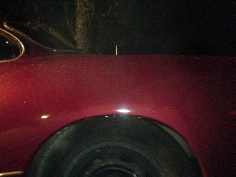

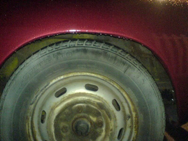

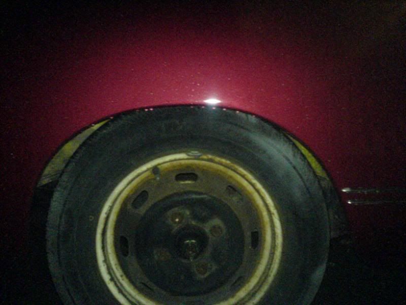

I'm sure this gets asked all the time, but can I fit 5.5" EMPI 8 spoke wheels with 195/60R-15 tires under my stockish '73 Ghia? It looks to be a perfect bolt-up for Bugs (Hot VW's Totally tech issue from a few years ago did it). I have about 2" between the top of the tires and the fender lip at all four corners, but will rubbing be an issue when I turn? Below are pictures of the stock tires (ugly as hell) in the fender wells for reference.
