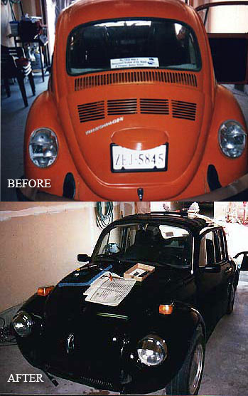

I drove my 74 Super to Earl Scheib for paint- Here's what I did.
I left the front windshield in, had the interior covered with drop clothes.
I removed the door seals.
I carefully lifted the windshield rubber seal (at the edges) and tucked a piece of rope behind the seal- and taped the edge of the rubber. - I did this so the paint guy could spray as close as possible under the windshield gasket lip. I removed the rope later when the paint was dry and secure.
I removed all the lights and taped the wires.
I already Very carefully masked all the trim pieces / door handles. I wanted tight paint edges.
I covered the interior trunk with a drop cloth. I taped around the edges in the inside. -Over spray protection.
I covered the engine.
I covered and taped the exhaust pieces that stick out.
I covered behind the front vent.
I removed the hub caps.
I wiped all the wheels down with armor all- Over spray protection. Easy off later.
I removed the running boards.
I spaced all the fenders with small washers.
I sanded and prepped the ENTIRE car, TWICE.
Take off what you don't want painted.
If you can't- cover it or tape it.
The manager at Earl Scheib- checked my work and Bumped me up to the next higher paint job at no additional cost. He told me that since they had very little prep work to do and that took more time than actual painting- I had done them a favor.
When I picked the car up later that afternoon ( the bumped me to the front of line also) The manager gave me a pint of the gloss black they used to paint it with (for touch up) and also told me they had painted my door jams too. Overall for $269.00, I was very pleased.
The paint job was good. The shine was about 2 feet deep.
Shiny Gloss Black with Chrome- Nice.
This picture stinks-\
Hope this is helpful.

This was in 1997.
I've done the same thing more recently.
Except the price went up about $100.00
Earl Scheib always has the 1/2 price coupon.

1-808VW. I sometimes miss the red pearl white paint job. Aloha Mike
