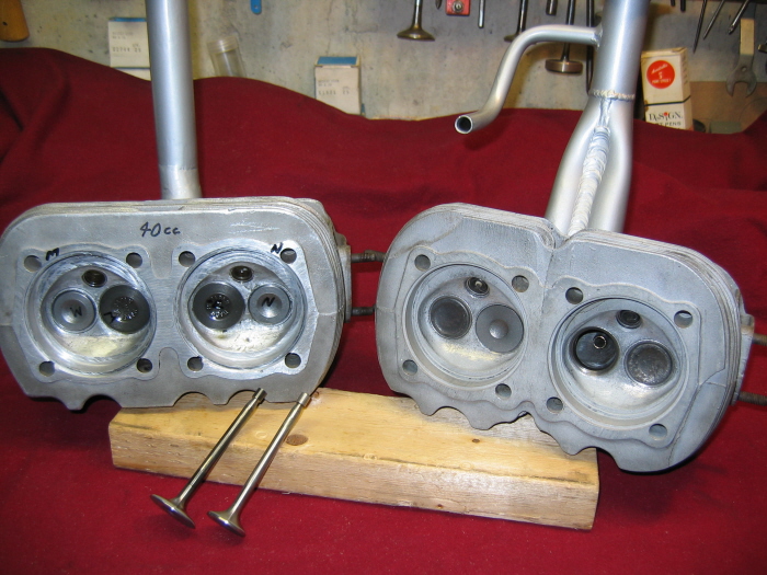

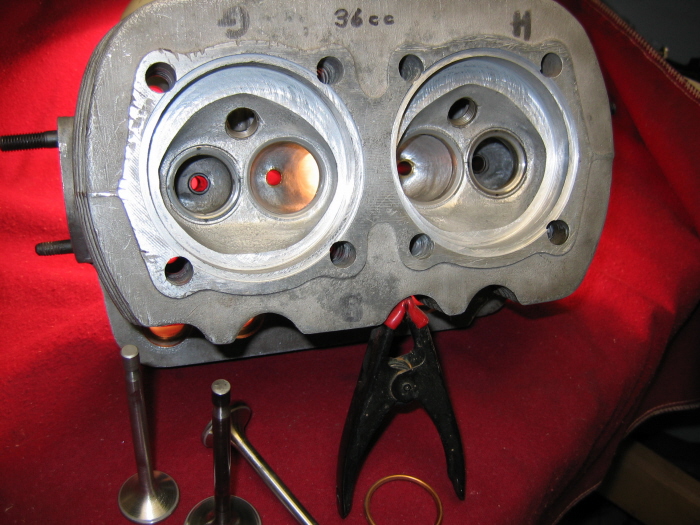

PostPosted: Tue Jul 03, 2007 4:53 pm    Post subject: BruKrasa 36hp singleport heads Reply with quote
After about a year and a half of work, I finally found the combination of modifications to make the 36 HP heads flow. After much R&D, grinding in the wrong places, testing and grinding more, I have worked out a whole system from combustion chamber to carburetor entrance that out flows the Okrasa set.
The plan is to make a Land Speed Challenge attempt with this "Brukrasa" head system on my 1378 cc (74x77) 1956 VW engine. We are trying to break the 94.40 MPH VW Okrasa sedan record of Ellis/Gosvig set at Bonneville in 1962.
I'll follow up this email with additional photos of the heads and manifolds. This file is the description of my process.
Bville Tom Bruch

One of the questions I was wondering is what valve springs are you going to be using for these heads? I have looked at many Possabilities from B series honda springs (Dual spring setup that would require clearancing the valve guide boss) to morris minor 1200 valve springs. Also just wondering if you were planning on usings Pre A style lifters to help with your motor.

bvilletom
Joined: January 22, 2006
Posts: 95
Location: cedar rapids iowa usa
bvilletom is offline
PostPosted: Wed Jul 04, 2007 8:47 am    Post subject: Reply with quote
Using brand new 36hp valve springs shimmed about 1.5mm and it gives 60+ lbs seat pressure. I tried the BMC 1200 inners and outter dual springs and they are too stiff. Running an engine similar to this now that turns 6k rpm with used stock shimmed springs. The lifter design does not tollerate extreme spring pressures.
