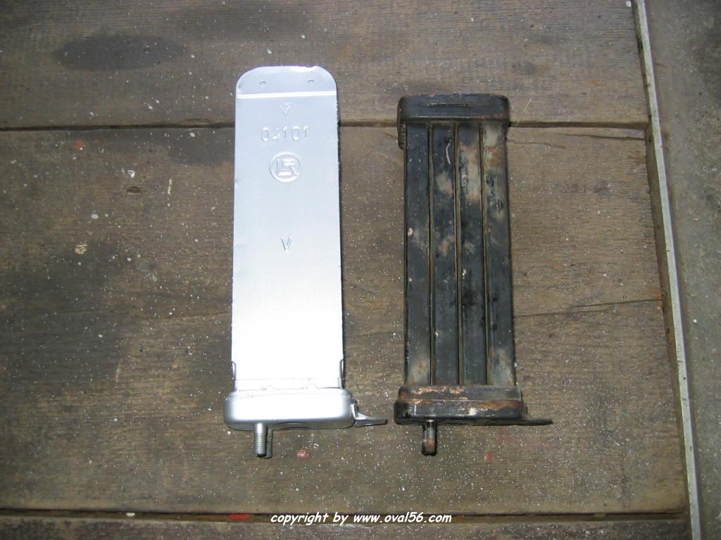

normaly you can use all 356 coolers, but some need some modifications, one type has 8mm studs, you ned to drill abigger whole in the enginecase to fix the oilcooler (6mmstud), the later 356c or 912 cooler have on top a nut to screw them on the fanhousing (vibration), you can cut this without any problem...
and also, there are different typs of fanhousings, one 36hp housings have on top in the front a dent, that ones whick have to be modified to fit on a 356 cooler... (have not enenough hight to some vanes)

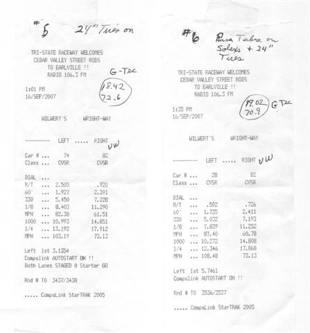

Attached are copies of the time slips from the Drag day last Sunday, September 16th for the Brukrasa 36HP VW beetle.
After rainouts a month ago, we finally got our drag strip day completed for test & tune. I got 8 passes in and tried different combinations of tire diameter & exhaust mods. The Brukrasa 36HP Vintage sedan ran 73.13 MPH @ 17.8 sec in the quarter mile. We had some wheel hop problems at first but had a really good time. The motor is still alive and ready to go to Maxton in October for the ECTA standing mile runs.
I don't know how these times compare to other vintage speed VW's but ThomasKaefer should know.

PostPosted: Wed Sep 19, 2007 11:15 am    Post subject: Reply with quote
Hello Tom!
Sounds great to me, really!
This weekend in germany there is race-weekend at Bitburg Airfield. I think, regarding on the last two years, a lot of oldspeed cars will be there!
I expect some comparing time to yours... so stay updated at oldspeed-register!

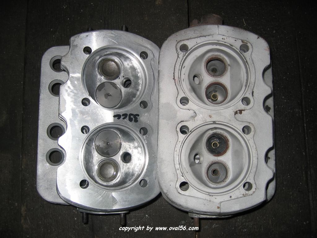

to kick off these high priced okrasa heads i`m creating my own out of stock heads.
I want to run double carbs, so i need a smooth flowing double port head Very Happy
at the bottom an orig. okrasa head
in the middle a "test" head to check thicknesses etc.
on the top the started prototype of my Wokrasa head

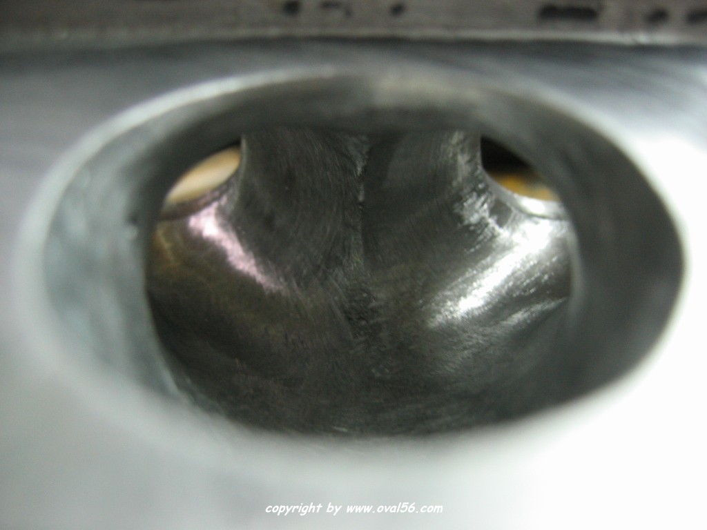

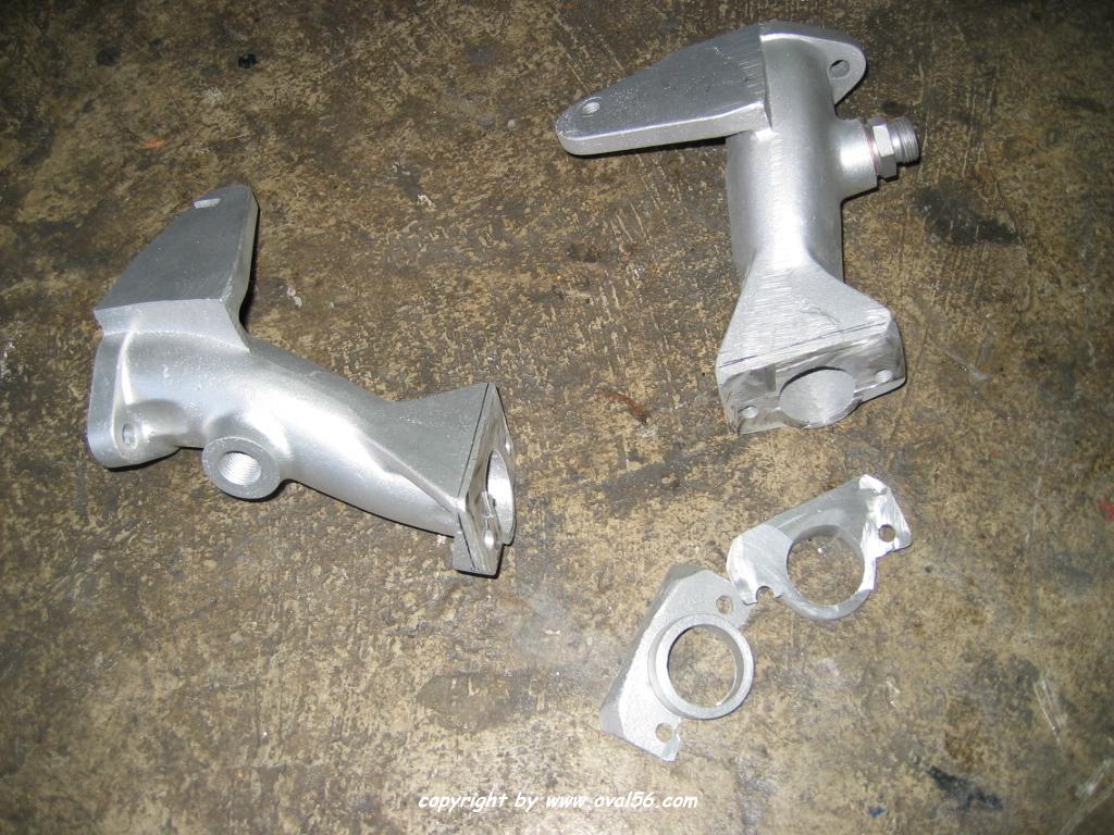

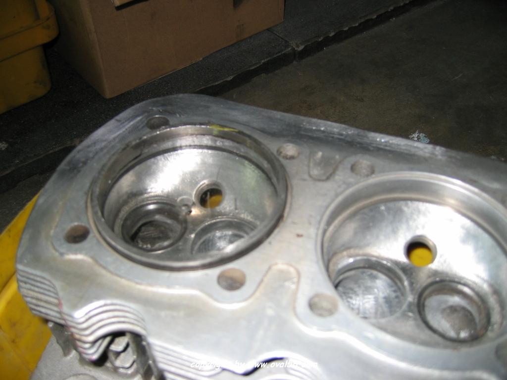

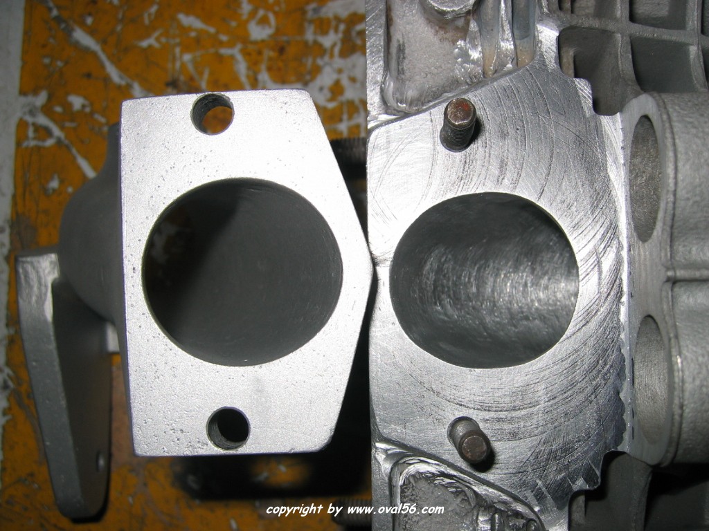

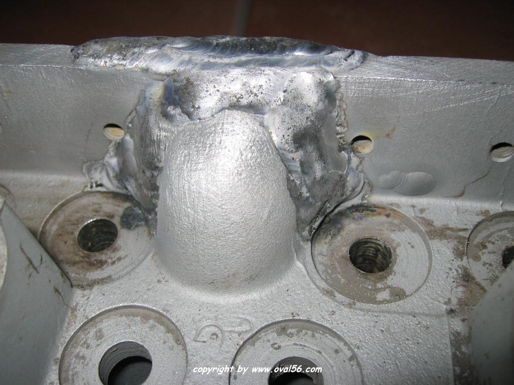

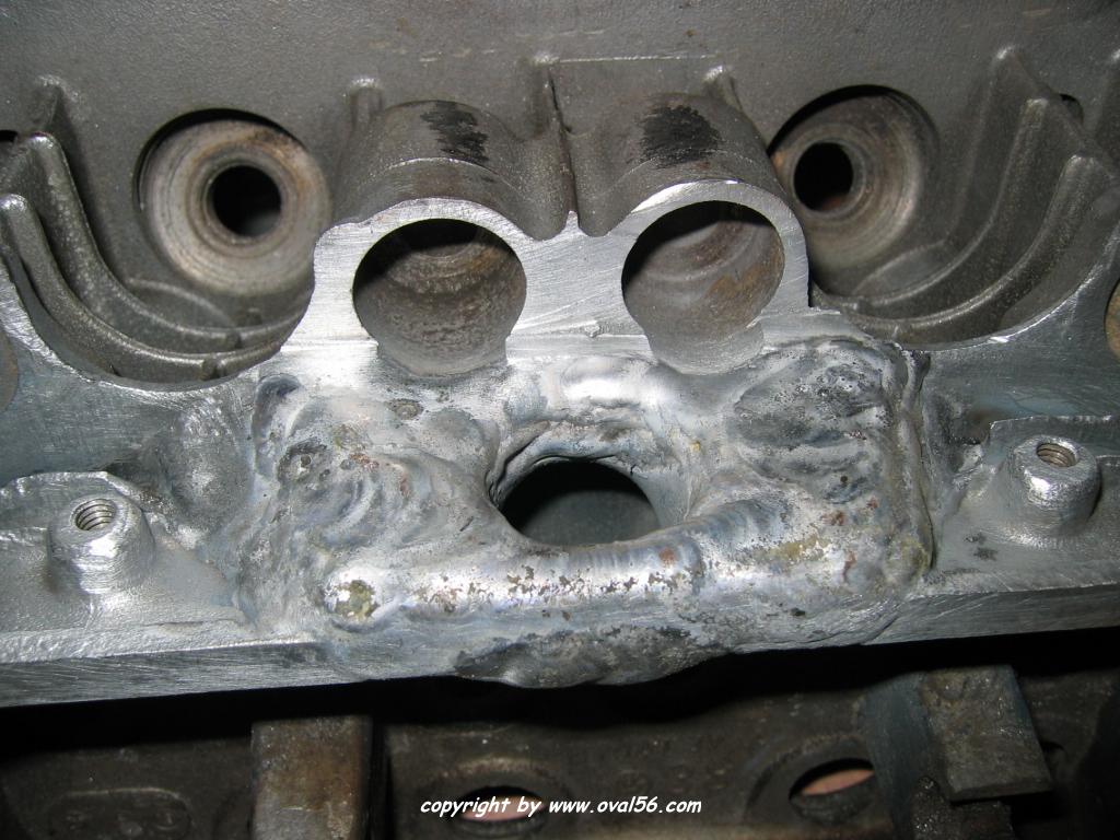

here are also some pictures of my new project, the Bukrasa inspires me a bit , and i try to make it at a little bit differnt way.
i used some riechert essen manifolds from a later 1300/1500 engine and modified them to use it later on my 36 hp heads with 2 34pci carbs on top
and now after som hours of grinding an porting:
to the rest of the angine:
modified cam, 74mm 356 crank, 77,5 vw pistons..... 36mm inletvalve, 34 pci carbs

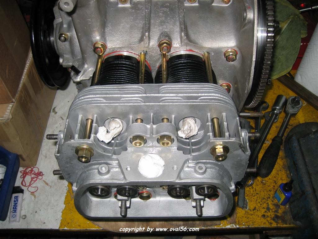

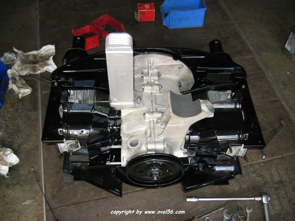

some update on my projekt, i do have now all parts back from my machineshop ( heads / new valve guides, valveseats.....)
now i do have 36mm inletvalves, and bore 78,5mm, the crank is a 356 porsche ( 74mm ) also the rods are 356 ( balanced and ligthened )
also i have to use some spacers (11mm) for the cylinders, the compresion now is 8,7:1
the porting of the heads was a long and hard to do job for me, to get all in the same shape... now i will put all parts together step by step Smile
more on my homepage ->
http://www.oval56.de/inhalt_ov57_21.html
