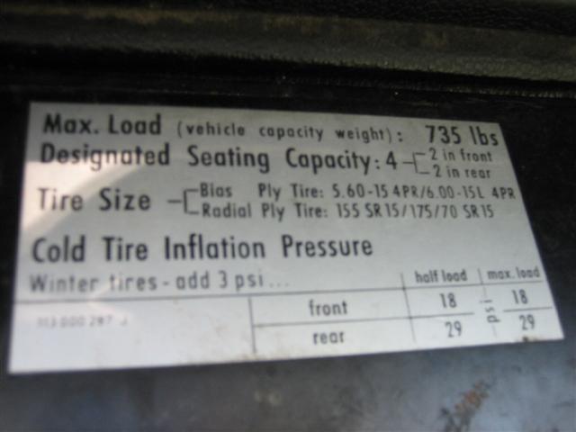

The stock size is 5.60/R15 as the manual says. I think the original size is 155, not 165.
I still have 5.60/R15 tires on my 71 super. When I compare them with the tires of my 72 super, they are skinnier. 72 has 165R15 tires.
IIRC the 155s were the bias ply tires, 165s are the radials (I think that's what it says on my glove box door)

Kelley

kelwa2 wrote:
I stand corrected Embarassed What year is that from? I just double checked on my 69, it doesn't give the dual width rating but shows "Max. Load just over 800 lbs. Question

My Mexi came with 155 radials stock. I have 165s on it now, but I am going to put a 155 back in the spare tire well as the 165 is really tight in there. I hink the '73-9 VWs actually came with 6.00-15s from stock, on a wheel rim that was 1/2" wider than previous years (is it a 5" that replaced a 4.5"?). They were bias ply from the factory. Sport Bugs that year came with 175-15 radials.

The wheels went from 4" to 4.5" around March '72.
Mine is a May '72 car and the sticker in the glovebox gives the bias ply size as 6.00-15 and the radial size as 155SR15.
