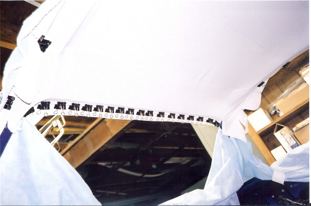

From kingkarmann's gallery photos:
He has a bunch of pics of his headliner installation starting on about the 4th page of his gallery.
[email protected]
Joined: February 15, 2003
Posts: 453
gecko@revolks.com is offline
PostPosted: Fri Mar 28, 2008 4:56 pm    Post subject: Reply with quote
Nice picture above Smile
You gotta have lots of spring clamps - i kinda' like the office depot supply in the above picture Smile but they are definitely required because as pointed out you will no-doubt have to tension and then re-tension your headliner multiple times to get all the little wrinkles out. If you are shy of a million clamps, make use of two clamps and some paint stir sticks or even thick popsicle sticks - whatever, small sorta' flexible wood sticks that will allow you to distribute spring clamping force over a wider span...
Doing the "first pass" as above and then coming back the next day is actually the way we do all headliners (ghia, beetle, bus - same). If it is a warm sunny day then letting it sit outside will help even more to allow the vinyl to stretch-out because it will... so why not accept it, not rush it and get better results?
Remember that the Ghia (coupe of course) has the aluminum and rubber seal that is secured to the side/rear quarter windows and so this helps secure the headliner laterally across the roof. If you are careful, you can hide the headliner seam _just_ behind/under this aluminum trim's location. (ie: cut the headliner excess off so that the headliner is hidden below this trim/seal but the headliner will still be secured by the small screws used to attach the quarter window's upper seal (that aluminum flashing piece).

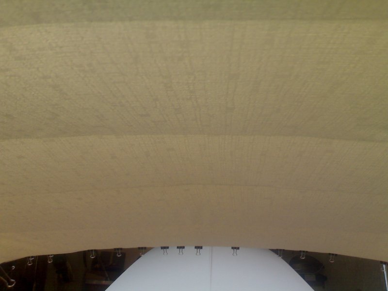

With the help of people here I was able to get the headliner hung today. I am happy with the results, as always it could be better. It was pretty straight forward, use a lot of binder clips and let the glue set up before you clamp it.
Thanks
Chuck

Looks nice, but it kind of looks like your iron left a burn mark on it?!!!! Shocked
vwairheads
Joined: March 26, 2007
Posts: 675
Location: chula vista
vwairheads is offline
PostPosted: Sun Mar 30, 2008 5:26 am    Post subject: Reply with quote
you should ask your wife to iron it for you Wink nice work though.
Chuck Fryer
Joined: May 18, 2004
Posts: 134
Location: Harvard IL
Chuck Fryer is offline
PostPosted: Sun Mar 30, 2008 5:37 am    Post subject: Reply with quote
vwairheads wrote:
I know, I know, I know.
She got a pretty good laugh out of my iron mark. For now it will stay there, someday I will rip that liner out and install ANOTHER one.

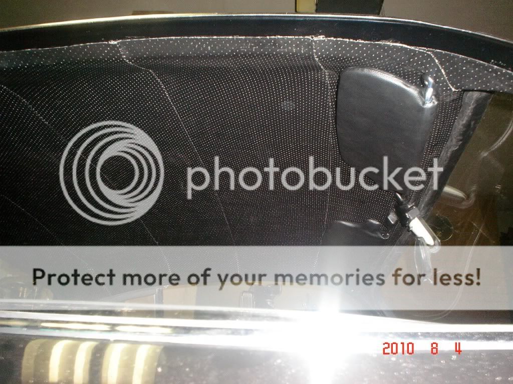

After reading the thread I decided to try and install it myself.
I took the old lining to the local upholstry shop. I had a new one made for R450 South African rand ($50)
Here is how it went. Thanks for all the advice!
