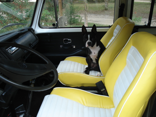

IMPROVING SEATING COMFORT & SAFETY
By the late 1980s, my family and I, were finding the 1973 VW Type 2's, factory-fitted cab seats, to be rather uncomfortable, especially on long journeys of more than a few hours; particularly the passenger seat, which had only two possible positions and which could not be adjusted whilst sat upon. Even the driver's seat, offered only adjustment of fore & aft position, plus the rake angle of the back rest.
As a driver, I found that after more than half an hour's driving, my feet and lower legs became numb (they went to sleep, to use the vernacular!), especially on motorways, unless I deliberately exercised them (i.e. constantly fidgetted!), which would otherwise have severely inhibited, my ability to initiate emergengy braking, if it were required. In addition to the seating discomfort, there was also a further safety concern, about the seats' lack of head restraints (not head rests!).
During more than twenty years, of sporadically visiting car breakers' yards in my home region, I had seen fewer than ten in total, of 1968~79 VW Type 2s and 1983~92 VW Type 25s (i.e. Vanagons, in USA parlance) collectively, of which none had cab seats with head restraints anyway. Hence, I sought a donor car, whose front seats offered increased adjustability, improved comfort and proper head restraints, whose height were sufficient to reach the tops of our heads.
Knowing that Volvo seats featured a high degree of adjustment and tall, rigid head restraints, I bought for £30 (at that time, about US$55), a pair of black, leather upholstered, front seats, salvaged from a Volvo 244GL; both of which featured considerable adjustment of fore & aft position, backrest rake angle and lumbar support firmness. In addition, the driver's seat had front & rear, three-position height adjustment, plus electrically heated pads, in the seat-cushion on which one sits and the backrest.
Before the Volvo seats could be installed, the original, welded-on VW seat mountings & runners, required removal, followed by build-up weld repair, of the underlying wheel-arches, which had perforated in places, owing to a combination of damage caused by the spot-weld cutter and long-term corrosion. The corrosion probably resulted from moisture collecting under the foam-backed rubber mats and spot-welded fittings, arising from one or both of water-vapour condensation and wind-driven rain, entering the cab when the doors were opened.
Adapter mounting plates (with captive M8 screw studding, to secure the Volvo-seat runners), were fabricated in the engineering workshops, at the laboratories where I worked. Reinforcement-plates, with captive M8 threaded nuts, were seam-welded beneath the front wheel-arches, to which the outboard, adapter mounting plates, were to be bolted. It wasn't practical to weld inboard reinforcement-plates, to the passenger-seat, seat-well framework, adjacent to the central aisle, so a long reinforcement-plate, with several M6 threaded holes, was used instead.
Although durable, the Volvo 244GL seats' black leather covering, is a little slippery, so there is a tendency to slide (albeit constrained by the seatbelts) forward or sideways in the seat, under conditions of braking or cornering respectively. The Volvo seats, have given much greater comfort, eliminating any feelings of stiffness, even after a long journey and there is no longer any problem with lower-leg & foot numbness, but the seating position isn't yet quite perfect.
As a 1•79 metre (i.e. 5 feet 10½ inches) tall, adult male, the raised front of the seat-cushion, is sufficiently high above the floor to support my legs, but the raised rear of the seat-cushion, results in my eye level being too high for optimum visibility through the front windscreen and my head comes close to touching the headlining. On level roads and downward gradients, this presents no inconvenience, but distant traffic cannot be seen, when approaching an uphill gradient. Sometimes, if I am not careful, my lower thighs, sometimes accidently activate the headlamp dip switch or windscreen-washer switch, when declutching or braking respectively.
Ideally, I would wish to slightly lower the front of the seat cushions, but substantially lower the rear, which would both improve forward visibility and reduce the tendency to slide forwards on the smooth leather covering. It should also reduce the risk to the driver, of inadvertently operating, the steering-column mounted stalk switches, when using the brake or clutch pedals.
Lower seat cushions, would also improve comfort, for people of short stature, such as my mother, who is 1•59 metres (i.e. 5 feet 2½ inches) tall, whose feet do not comfortably reach the floor, despite the 25 mm (i.e. 1 inch) total thickness of high-density foam elastomer (discarded thermal conductivity test samples, I scrounged from the laboratories, where I worked!) and a remnant of carpet underlay, beneath the cab-floor rubber mat.
As shown in the following picture, reproduced from a recent motoring magazine editorial (Hilton Holloway, "Avoiding a pain in the neck: How manufacturers still need to wake up to whiplash injuries.", This Week, Autocar, 21st March 2007, p23), the top of the head restraint, should be no lower than eye & ear level and preferably level with the top of the head. Also, the neck should not need to flex noticeably, when the back of the head is positioned hard against the head restraint.
Despite the Volvo 244GL seats, dating from the late-1970s or early-1980s, the associated head restraints, largely satisfy these criteria, being virtually level with the top of my head and quite close behind, although in principle, they could be a little closer, without causing neck discomfort, but they are somewhat firmer than I would wish to rest the back of my head against.
Being about 25 mm (i.e. 1 inch) behind my usual head position, the head restraints benefitted from the addition of a home-made, 20 mm (i.e. ¾ inch) thick, supplementary head cushion, fabricated using high-density foam elastomer (more discarded thermal conductivity test samples!), whose additional shaped sections on the back, are a press-fit into the head restraints' twin holes (intended to give rearward vision, when reversing the Volvo, in which they were originally installed).

i_am_cool_fred
Joined: June 26, 2004
Posts: 1743
Location: Benton, AR
i_am_cool_fred is offline
PostPosted: Thu Nov 13, 2008 6:47 am    Post subject: Reply with quote
This dog is not strapped in...
it's a harness my dogs wear them too:
as you can see here, my bassett hound is wearing one too. it is to move the leash connection towards the back of the animal to better control them and not choke them when walking them. NOT A SAFETY HARNESS TO STRAP A DOG IN A SEAT, those look completely different:
this dog has the safety belt harness on
proud owner of a defunct 1979 sunroof kombi
Brian Denning, as seen on Gearz TV
