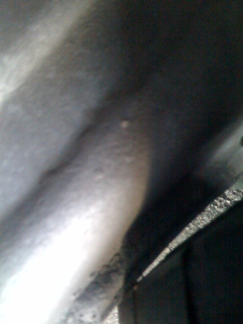

PostPosted: Thu Jul 03, 2008 10:50 pm    Post subject: wheels that don't really fit Reply with quote
mercedes-benz 18x9.5 rear with kumho 265-35W18 tires.
just kisses the trailing arm, nuts only go about half=way onto the studs, don't even think about opening the slider more than a foot.

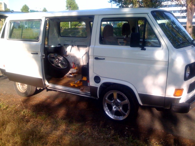

PostPosted: Tue Jul 08, 2008 8:52 pm    Post subject: Reply with quote
testing the big wheels again today with some cheap spacers, 1/4" on the rear and 1/2" on the front.
18X9.5 ET 38 rear and 18X8.5 ET 35 front
looks like this,
