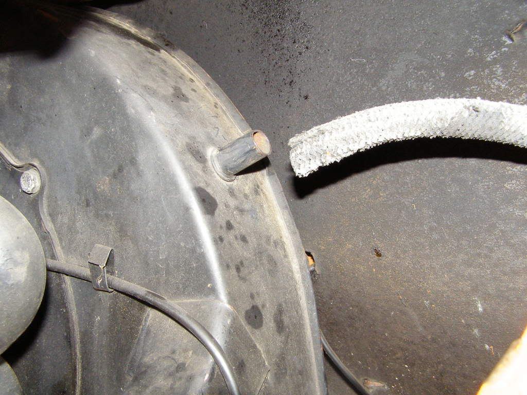

There is a hose on the right side of the engine fan housing that runs to the charcoal canister ( I think its a charcoal canister).........anyways, mine is split where it goes over the barb on the housing and won`t stay on..........
any effects performance wise with this off?
Roger
Roger
Glenn Premium Member
Mr. 010
Joined: December 25, 2001
Posts: 80077
Glenn is offline
PostPosted: Mon Jul 07, 2008 7:40 pm    Post subject: Reply with quote
Just cap the nipple on the fan shroud. I removed the charcoal canister and hoses years ago.

mnussbau
Joined: August 26, 2006
Posts: 4610
Location: Central Maryland
mnussbau is offline
PostPosted: Mon Jul 07, 2008 7:49 pm    Post subject: Reply with quote
The canister is there for emissions purposes...having a working system really has no affect on engine performance, and prevents raw gas fumes from venting to the atmosphere. Up to you, but I restored the system on both my bugs. New hose is available, I think this is the stuff...
http://www.oeveedub.com/mm5/merchant.mvc?Screen=PR...gory_Code=

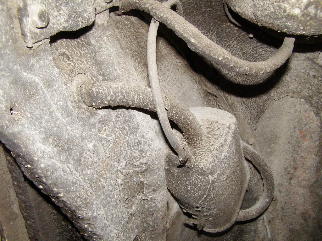

PostPosted: Mon Jul 07, 2008 7:55 pm    Post subject: Reply with quote
here they are here......

2002sportside
Joined: January 27, 2004
Posts: 1496
Location: New England
2002sportside is offline
PostPosted: Mon Jul 07, 2008 8:00 pm    Post subject: Reply with quote
Rogeroo wrote:
I too have the one in the trunk....
I`ll at the very least try to keep that one in tip top shape.
Roger
You got some petrified hose up there...
I had to do mine in the trunk, the gas smell was getting bad. The filler neck hose wasn't the problem, it was all the other stuff. In the end it was worth going to a show and buying some of everything to get it fixed. Just need to replace or regut the canister someday...
1973 Volkswagen Beetle never ending project
66foot
Joined: November 19, 2006
Posts: 398
Location: Pacific Grove, California
66foot is offline
PostPosted: Mon Jul 07, 2008 8:44 pm    Post subject: Reply with quote
The canister in the trunk is just a hollow expansion chamber (2). It allows your gas tank to "breathe".
The canister in the wheel well is an evaporative emission canister (1). It allows the rest of us to breathe.
Pat (66foot)

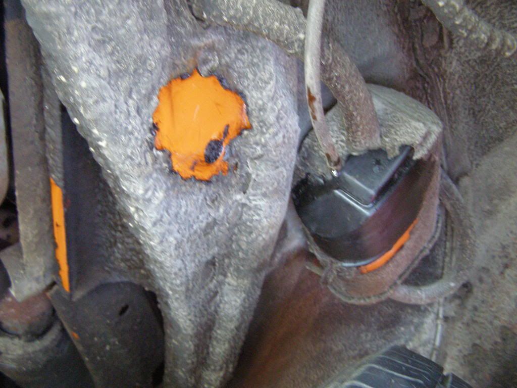

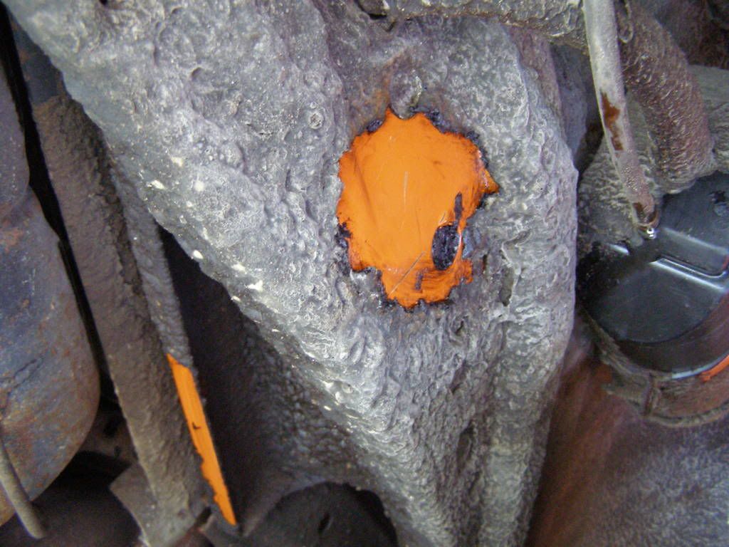

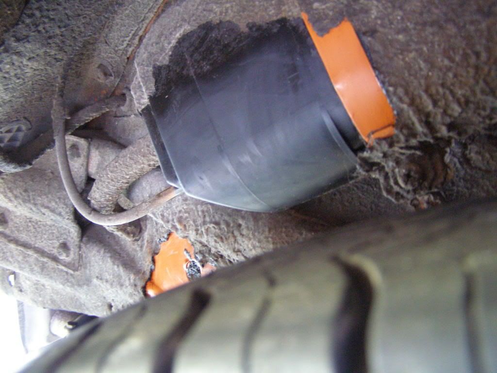

Rogeroo
Joined: June 15, 2008
Posts: 505
Location: Waterdown Ontario
Rogeroo is offline
PostPosted: Tue Jul 08, 2008 5:23 am    Post subject: Reply with quote
Buggin_74 wrote:
damn the underneath of ur bug needs a good pressure wash
I will have to agree with you that, at a glance the underside appears to have the attraction of a red-headed stepchild, but I dare say whatever this glitch is that has been pasted over 95% of the underbody componants has done what it was intended to do.
With the exception of the front left fire-wall area and heater channel in that same area where I have recently found out was the fault of a drain tube running through the hole in the trunk........its been effective.
Ugly?..yes, effective.......so far it seems as though it has been.
I took a plastic putty knife and scraped away some of the junk and this is what it reveals..........everywhere that I have scraped little areas off prior to purchase for inspection purposes has revealed the same bright orange paint or in the areas that WERE shiny black, are still that way.
Even on outside end areas that typically get rusted first were covered and have shiny orange under the coating.
So yeah, it is ugly for sure but its one of the reasons I bought the car.
I looked at several cars and this one was the best in terms of hiding 'the good stuff'......
I just wished whomever ran that fresh air box drain , hadn`t of done it down onto the front left portion of the chassis head.
Anyways,,,,,
here is some pics, I just took a plastic putty knife and shaved away a couple of spots to see whats under it all.
Pehaps one day when the body comes off to do the firewall and portion of channel, I will scrape it all off and then recover with some sort of rust protection like a por-15 or rust bullet....but til then I`ll put a hand to it as I would that very same red headed stepchild. Laughing
I`ll love it like it was my own Smile
