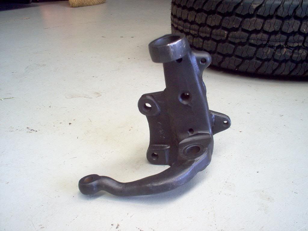

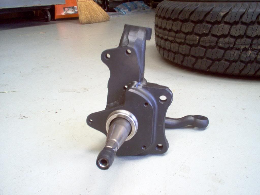

The front spindles are the way to go for a small lift..... Nate at www.Wagenswest.com built them for me...

My frontend is just raised spindles and coil over shocks..... that's all... I really didn't need pics. With this lift 28" on the front and 32" rears will fit....remember you will have to provide clearance the rear fenders for larger tires.... Smile

wow, that front end looked a lot higher than just what lifted spindles would do. I will cut and turn my beam, rather then coil overs, figure it will ride nice, esp if i poney up for some adjusters I can dial it in. how much are those spindles lifted? looks pretty good.

Believe it or not it's a very smooth ride.... The coils i use are for the rear of a bug.... they fit perfect and give a little more support for my big self....
I didn't want to go through the time and expense of installing adjusters up front... didn't need too..... it's high enough and rides very nice....
The front spindles are 2-1/2" or 3" lift......... heck i can't remember... I still have small amount of rub when going over curbs and large bumps....while turning..... and i did hammer the front for some clearance along with removing the front jackpoints..... the rear fenders are some of my nicer work.... Cool
