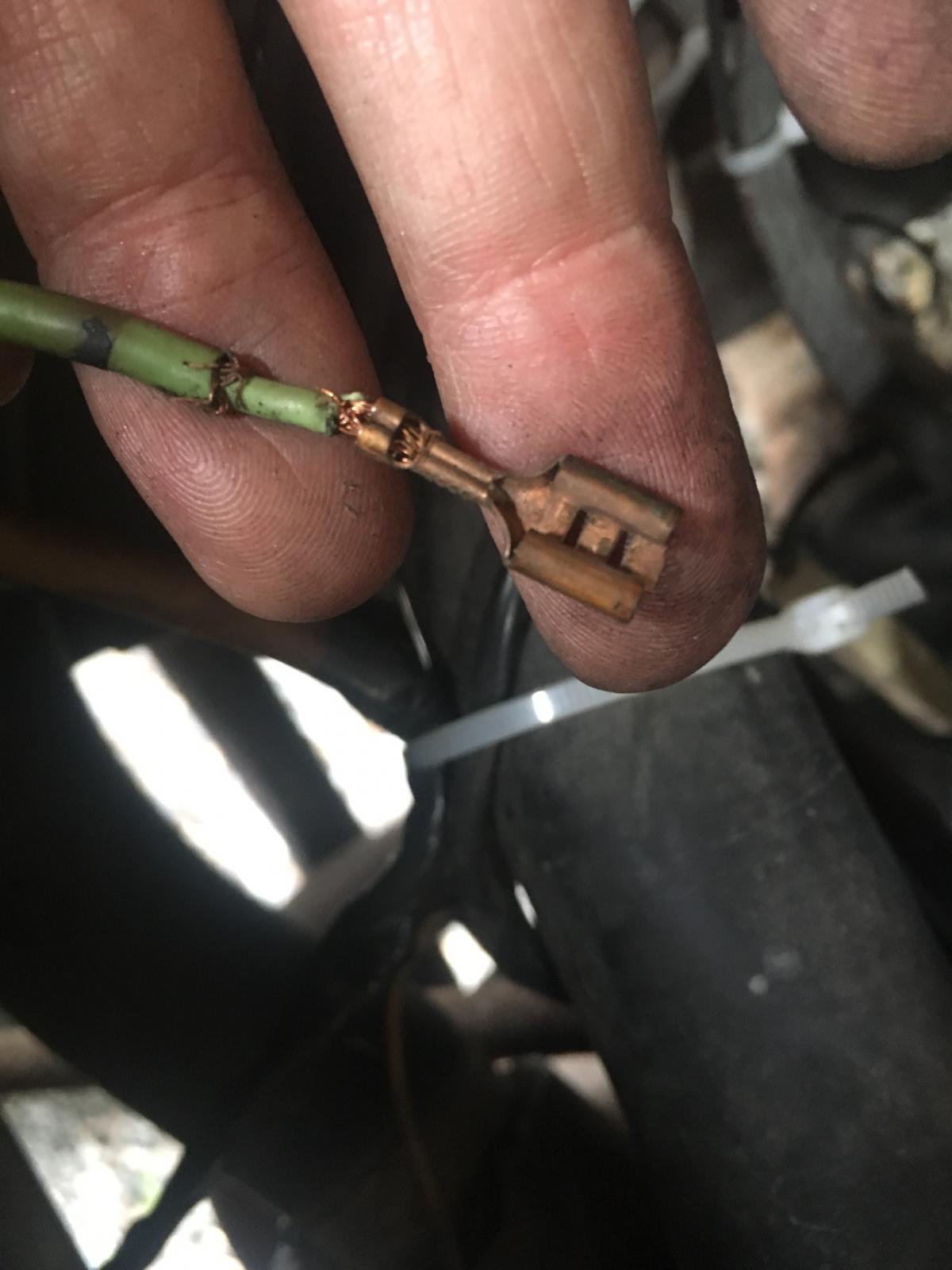

PostPosted: Mon Jun 03, 2024 3:43 pm    Post subject: Digijet O2 sensor shield connection Reply with quote
I had a question about the grounding of the coax shield of the O2 sensor.
tencentlife wrote:
Pull the small rubber boot back from the double-male connector that should be on the free end of the coax. Now take the first probe from the signal wire at the end of the coax, and touch it instead to the coax sheathing braid. Touch the other probe to ground. You should see zero ohms. This confirms that the noise-suppressing sheathing is properly grounded (it is grounded up near to the ECU harness connector).
Don't be tempted, by the way, to ground the free end of the coax's sheathing braid. It is grounded up near the ECU, and to cancel noise a sheath like that can only be grounded in one location.
[/i]
I did not see conducting path to ground (pins 7 and 25 or the FCU cable), so I opened up the plug. I saw that the shield was actually connected to pin6, which is not to ground but to the air flow sensor potentiometer. This is consistent with the digijet wiring diagram copied here. Would you please clarify that this is the best way to connect the shield on the O2 sensor? Thanks!

PostPosted: Mon Jun 03, 2024 4:28 pm    Post subject: Re: idle fluctuation up/down running RICH 84 Digijet 1.9L Reply with quote
Digijet ECU is supplied a ground from the cylinder head on its pin 7. Inside the ECU, pin 6 and 7 are bonded/connected together. The ECU uses pin 6 to supply this ground to the AFM and O2 sensor shield.
'Best' in this context is usually to keep things stock/standard. Makes for easier troubleshooting. If it were to be re-engineered, maybe an ADC within the O2 sensor outputting a digital value to an ECU would be better, but that would be beyond the realm of Digijet. The Digijet was engineered for the O2 sensor it uses and its sensitivity and noise mitigations were taken into account in its design.
