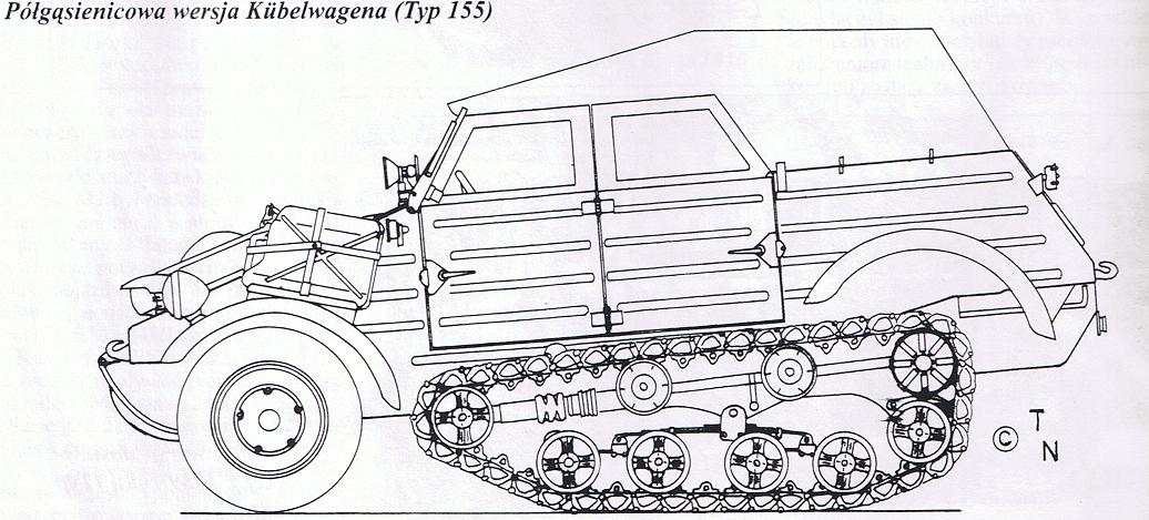

I have a book about KDF cars by Terry Shuller (SP?) that shows a variety of military VWs and there was at least one half track in it.

I remember that during WWII the Germans had a car that was used by Rommel that had a half track set-up. It was a little larger version of a Thing and did look pretty cool. They ran it in the desert campaign in North Africa.
