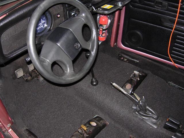

You can use a watercooled steering wheel up to the MK2 (I've been told you could use any watercooled steering wheel but I have not confirmed it). Anyways, I've installed a 92 GTI wheel into a 74 super. Here's what I did to do it:
-You will need a small spline steering shaft. These are found in mid year 74's and up super (don't know about standards). The 74 uses a steering box....the 75 and up use a rack and pinion. The steering shaft from a 74 is 1/2" smaller in length than a 75 and up. The extra 1/2" is right where the shaft connects to the steering arm. Don't bother trying to swap shafts from a steering box car to a R&P car unmodified since its not going to fit without modding something. Since my car is a late 73 it had the wrong shaft....and when I test fitted my 78 shaft that is where I noticed this issue. I had to use the top of the 78's and the bottom of the 73's to make it work (I also did a little reinforcement since I didn't want the weld to fail...after all this is the steering shaft...so what ever you do make sure it will not fail). I will be doing this again for my 72.....when I do I will use a 74's shaft and not do any cutting/welding.
With your modded shaft (or if your lucky you have a small spline shaft to begin with) you will be able to bolt on an watercooled steering wheel up to 87 as well as porsche 924 and 944 wheels (don't know what year for those). The best way to make sure is to look up a GRANT steering wheel hub. If the hub is the same model # as one that would be used on a 75 thru 78 super beetle its a direct bolt-on.
http://www.grantproducts.com/showapplications.aspx?year=1975&make=VOLKSWAGEN&model=BEETLE you can see here that model # 3568 steering wheel installation kit is what you would use on a 75 super
http://www.grantproducts.com/showapplications.aspx...GOLF%20GTI and the same steering wheel installation kit is used on 87 GTI
Now...lets say you wanted to use a later Corrado/GTI steering wheel. What VW did was use an adapter sleeve (small spline inner....large spline outer) on an early watercooled shaft to fit that wheel into the MK2 cars. http://forums.vwvortex.com/zerothread?id=2059093 look at the 3rd and 5th pic down (it'll have 2 steering wheel pullers....at the center is the adapter your looking for). You can order them thru the dealer as well (about $35 to $40). Or you can find them in any MK2.....they are a major PITA to remove so if you want to save yourself a fight buy it from the dealer.
Once you have the adapter you'll have to slip it on the shaft (it will be a tight fit). After that the MK2 wheel will just slip on. You will have to modify the wiper arm stalk to clear the wheel. I ended up cutting it, and reshaping the cut piece and then reattaching it. Works fine....but a later mexi-beetle's stalk may be your best bet.
Here's a pic of it in my car:
