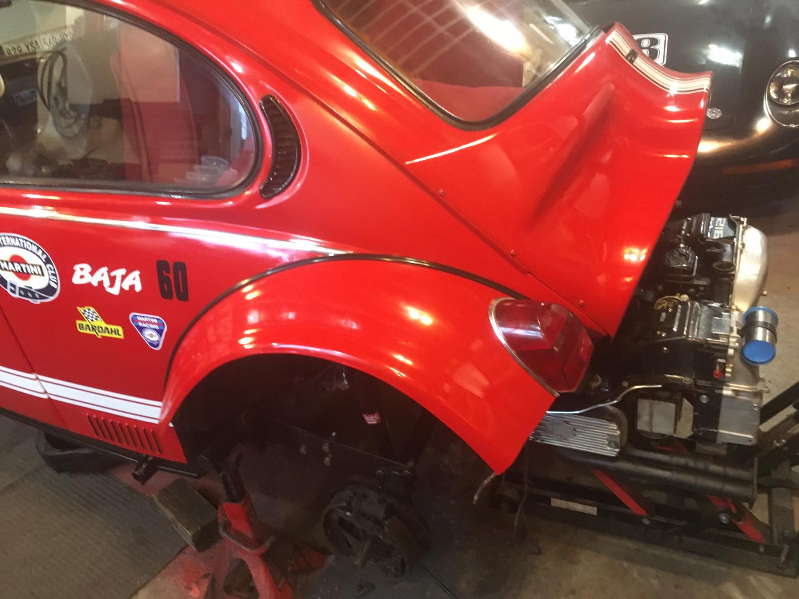

For a Baja it's easy, the Type 4 Porsche engines bolt up and simply hangs out the back. You must use a Kennedy conversion 200mm Flywheel since the VW T4 Flywheels used in the Bus are too long (ask me how I know). The Porsche 914 Flywheels are even longer so they won't fit into the VW tranny either. Also, the engine is about 250 pounds all dressed so if rear engine mounts are NOT being used you should use a transmission strap kit to bether support / attach the tranny to the forks structure. Also, you should custom fabricate a doubler plate to strengthen the driver side top bell housing bolt hole out of steel that fits over the bolt hole and snugly covers the bell housing area or eventually the engine bell housing flange will crack since there is a factory inspection hole close to the mount bolt hole, as cast into the engine case, so it's week in this area. I will post a pic of the one I made. This is not needed if you adapt and weld the rear engine mount support bar to one of the rear Baja style rear engine cages available from specially suppliers.
