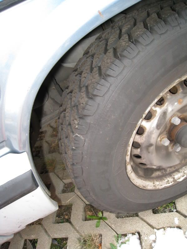

PostPosted: Mon Nov 23, 2009 10:45 am    Post subject: Re: Eurovan steel wheels- to a syncro vanagon Reply with quote
Mick Ord wrote:
I have a set of 15" steelies from a Eurovan lying around doing nothing !!!.....what do i need to do to make them fit the syncro vanagon ???....i believe the centre bore needs opening up...how much ?, and how should i do it ?
Will the standard hardware work ?
Thanks
Hey Mick,
The Eurovan usually uses a fairly high offset wheel. I haven't looked it up, but I think that the 15 Eurovan wheels are a 45mm offset. depending on the width of the wheels, a 12-15mm spacer would be required along with longer rear wheel studs, proper rear lug nuts and longer front lug bolts.
I recommend that the centers of the wheels need to be opened up to 66.56mm. Best to have a machine shop do the work since the wheels are balanced off of that center hole. If the center hole is not true, the wheels will be very difficult to balance.
Last edited by Christopher Schimke on Mon Nov 23, 2009 10:48 am; edited 1 time in total

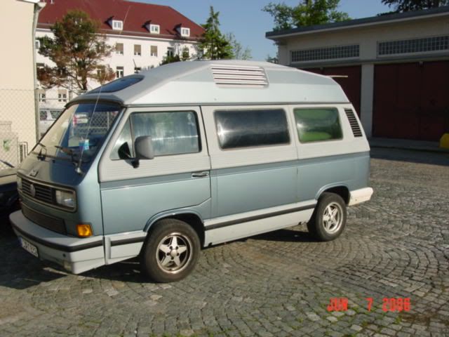

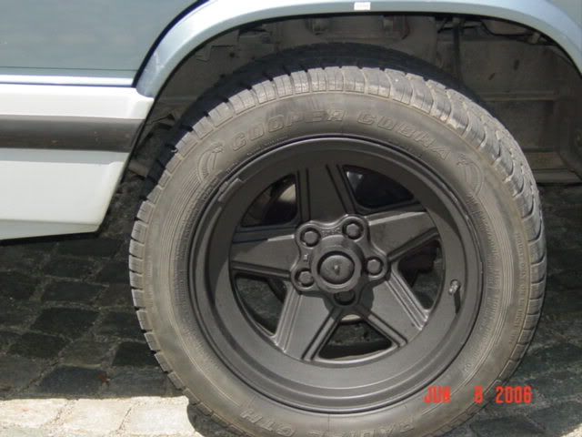

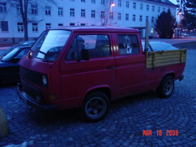

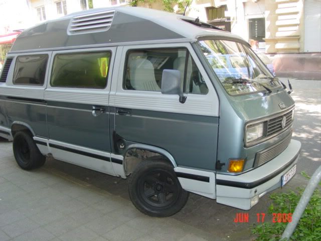

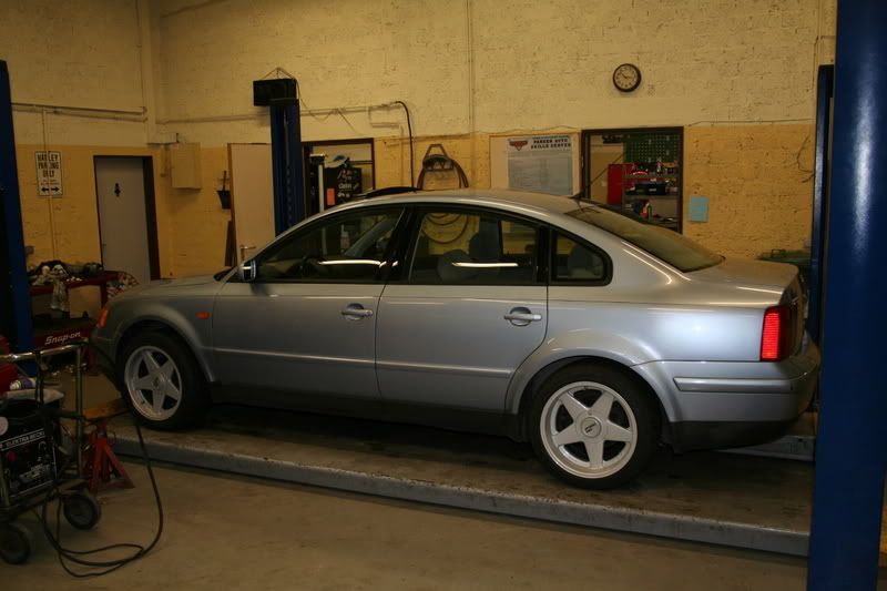

A few pics of some previous rim/tire combos.
Borbet type A 17x8.5 and 17x10 (I will see what the offset is.) These were made by Projekt Zwo specialy for T3's (vanagons)
AMG Penta wheels 16x8
Stock wheels with Goodyear Cargo ultra grip.
Stock Syncro 16 wheels on my old self made westy
My Eurovan with 17x8 RH wheels (Had them on my DOKA too with different spacers from RH.
Atzev type A wheels made for Projekt Zwo 17x8.5 and 17x10 (machined out center bores to 66mm) had them on my Passat for a while just to see.
Another one with the Amg Penta wheels
Same van with 15" ARC wheels
Another set of wheels from my trusty rusty W126 that ended up on one of my VW's
And another set of AMG penta wheels on my first DOKA
Another W126 that I used to own (these BBS wheels would have looked good on my new DOKA.)
Had these wheels that were turbo twist replicas from RH as well. Had spacers from RH.
