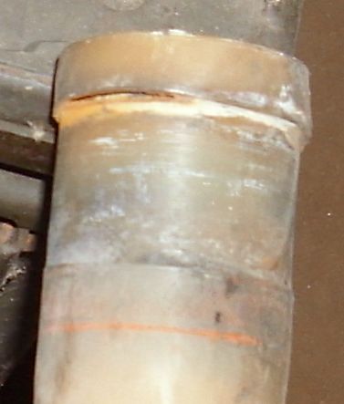

PostPosted: Wed Jan 27, 2010 7:20 pm    Post subject: Reply with quote
The barb doesn't break allowing the insert to then move, the insert moves first, breaking the barb on the way out and carrying it with it.
The GoWesty fix assumes the insert moves while the hose stays put. That is not quite how mine failed. The hose on mine moved out with the insert. The GoWesty approach can't seem to work if the hose moves too.
Maybe they don't all fail the same. Or maybe the hose doesn't move right away, but gets a growing pulling force on it as the insert AND BARB move into it eventually reaching the narrow part inside and then the hose clamp can't keep the hose in place. I don't know.

I just looked at the ends of 6 pipes I have saved for future use. I'm fairly certain the plastic barb is part of the plastic pipe. It appears to me that the barb was machined into the plastic after the metal insert was installed. The barb looks like it was formed as part of the operation that made the recessed hose clamping area near each end of the pipes.
Look closely at the next photo. If you compare the ends of the 2 pipes I think you can see the problem in an early stage. The upper pipe has the insert still recessed in from the edge and the plastic barb has an angled slope. The lower pipe has the insert moving out and you can see a white ring inside where the bulge in the metal insert has moved about half way through the barbed section, flattening out the barb surface in the process.
Mark

?Waldo?
Joined: February 22, 2006
Posts: 9993
Location: Where?
?Waldo? is offline
PostPosted: Wed Jan 27, 2010 10:45 pm    Post subject: Reply with quote
Thanks for the pics, Mark. Very interesting. All the separated inserts I've seen looked almost exactly like this pic from the GoWesty site but with the insert pulled out varying amounts:
The barb was attached solidly to the steel insert.

Yes it seems there may be some variation in the failure modes. Here is one of my pipes that has a tear starting in the barb as the insert pushes out. I think it is headed for the classic type failure with the barb detached and stuck on the end of the extruded insert. I have thrown away all my removed pipes with really ugly failures so what I have left are what I consider good or pretty good pipes. Even those are far from perfect.

tencentlife
Joined: May 02, 2006
Posts: 10147
Location: Abiquiu, NM, USA
tencentlife is offline
PostPosted: Wed Jan 27, 2010 11:06 pm    Post subject: Reply with quote
I think it's made of a piece. Seems to me the sleeve is cast in place with the plastic as reinforcement for clamping, the barb and clamp recess are formed by the mold. Then the pressure pulling against the back of the barb strains the weak point in the plastic which cracks along that line, and the barb with the sleeve start working their way out.
Vibration probably plays a role in initially fracturing the plastic behind the barb but also later in inching the sleeve out of the body of the tube, but I think pressure is the main force at play in pulling the juncture apart.
