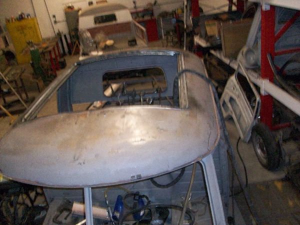

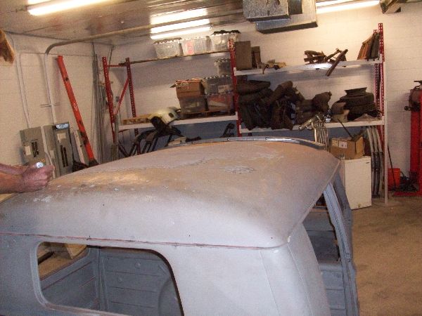

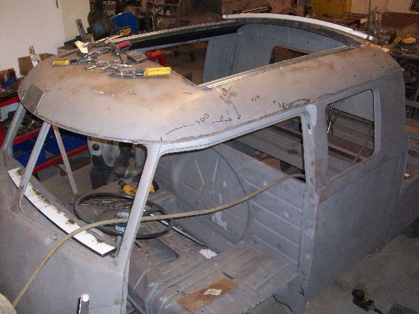

this is a split window we did last week
the cut line is laid out with a scribe and blue line tape to make it easy to see
with the hole cut the inner structure is fit and then clamped in place
with clamps in place the sunroof inner structure is welded in
the spot welder leaves a nice factor look
Thanks for looking

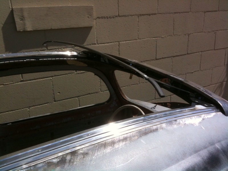

all these parts are new from vwsunroofs.com
Thanks for looking
