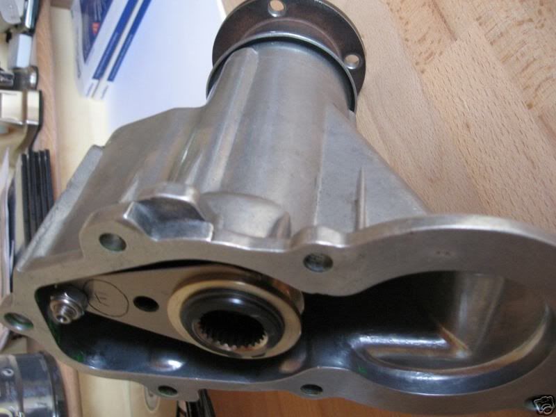

I've pulled my spare 4.57 front diff out of hiding and have put the solid shaft in rather than a VC as I've never tried offroading with one. This will be swapped over in the next week and I'll also get to change an inner CV boot which has just started to split.

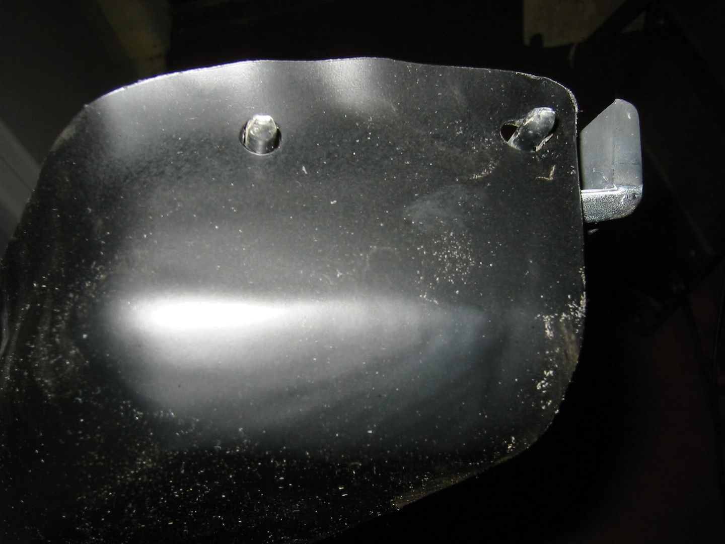

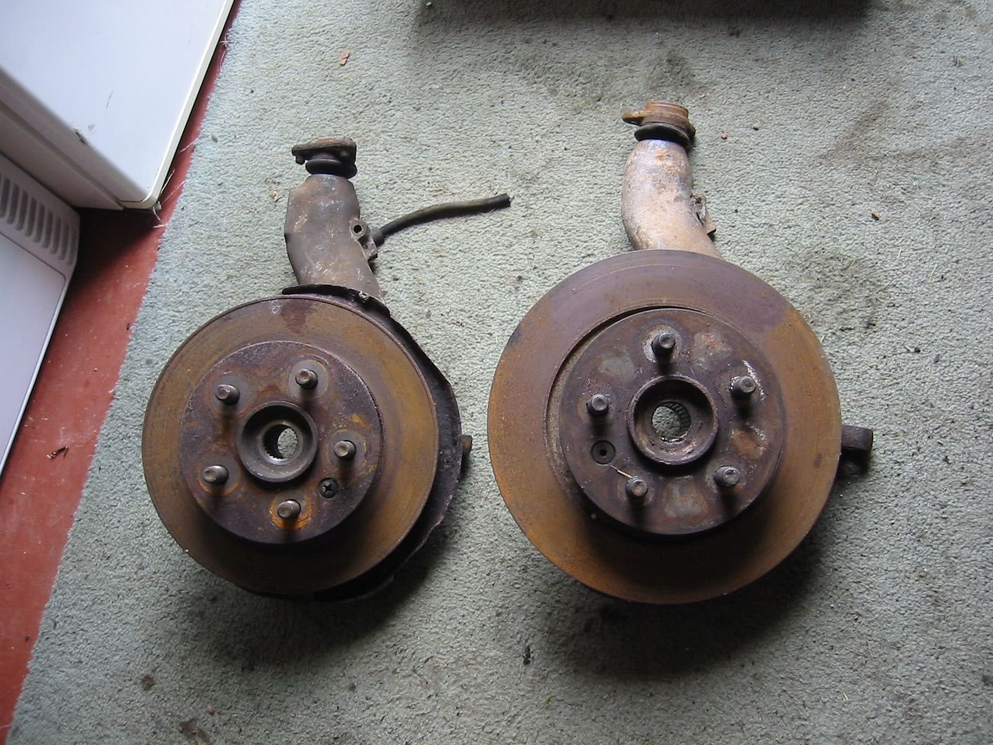

I've been looking at the front hubs (uprights) as they're catching the springs on full drop.
Something I noticed about Syncro 14 uprights (as this is what I'm running on Limey atm) is that they have a casting lump sticking out at the top on the side. You can see it on the upright on the left (this photo shows a Syncro 14 and Syncro 16 upright). Note that the syncro 16 upright is completely smooth.
I've also found that this casting is more pronounced on some than others and unfortunately they really stick out on the uprights on Limey and when the steering is turned on full lock (or close), this catches the spring coil and is making a mess. I'll be trimming this lump off so it's nice and smooth as per Syncro 16 uprights.

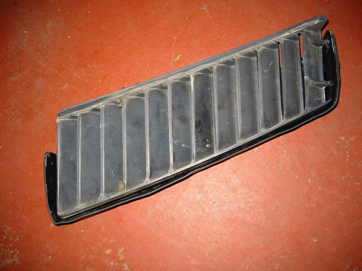

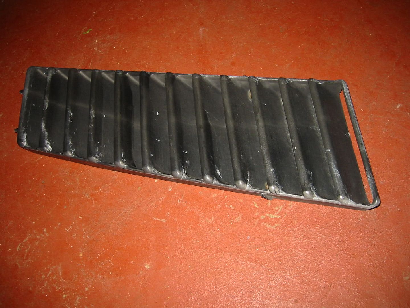

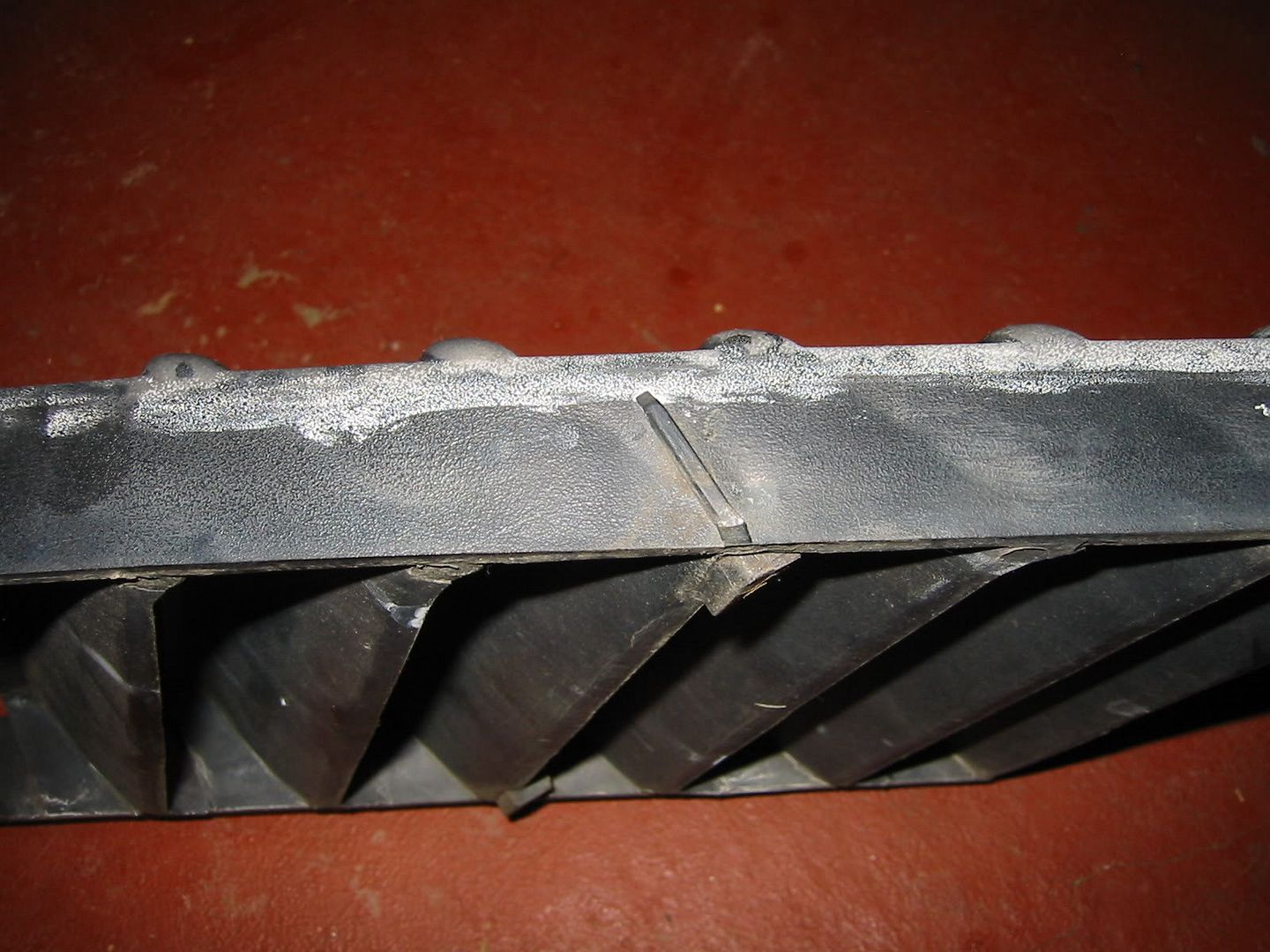

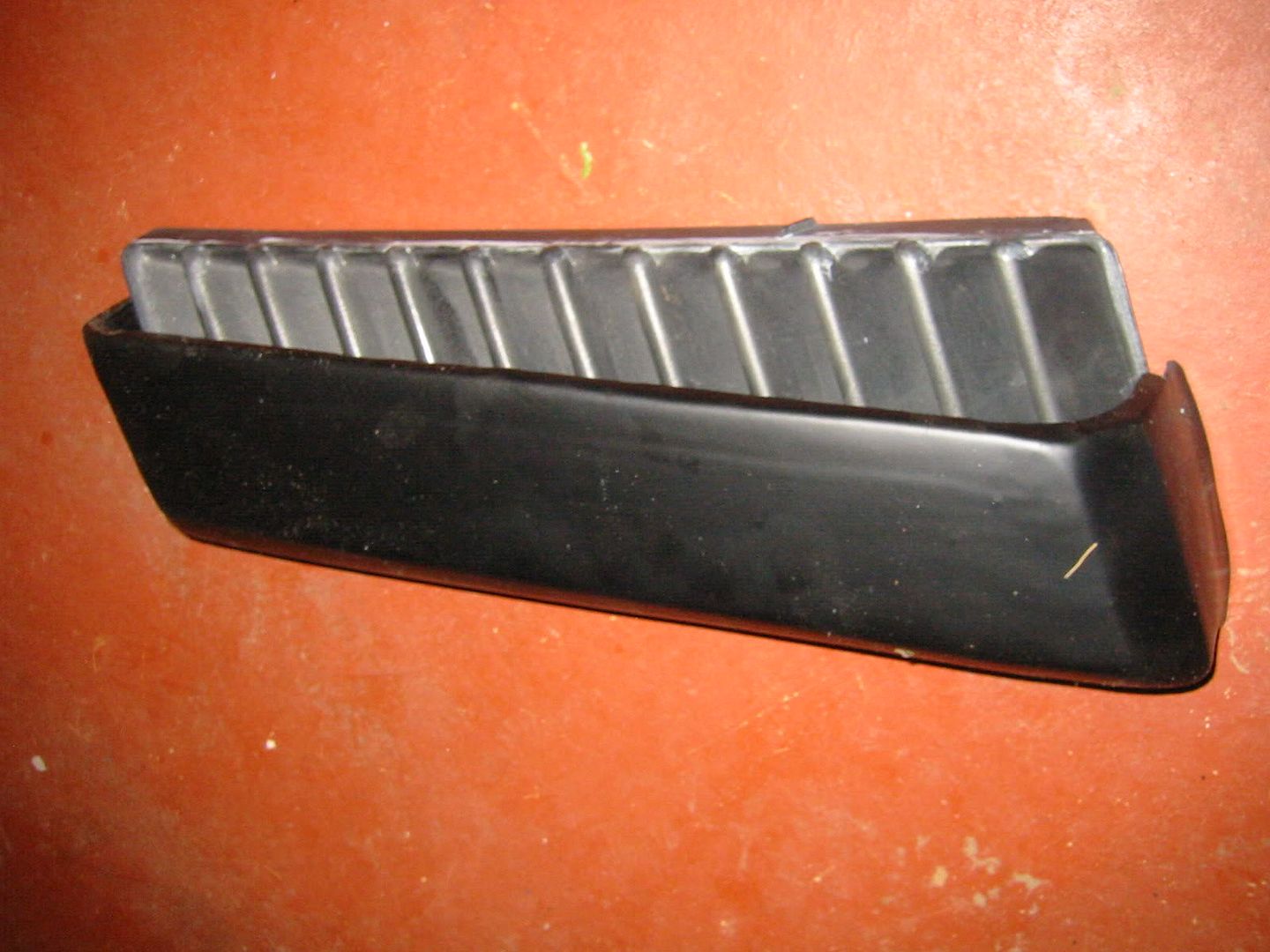

I've bought a set of air vent scoops to help with the oil temps.
http://cgi.ebay.co.uk/ws/eBayISAPI.dll?ViewItem&item=190402099628&ssPageName=STRK:MEWNX:IT
I'd umm'd and ah'd about this particular product as the seller doesn't exactly rave about the quality in the auction but after having a look around, there really isn't anything else on the market for this kind of money and as I'm not a fibreglass guru... they'll have to do.
I've taken a few photos of what's involved in fitting which is fairly simple and the end result.
You have to remove the excess material here so the scoop will sit flush.

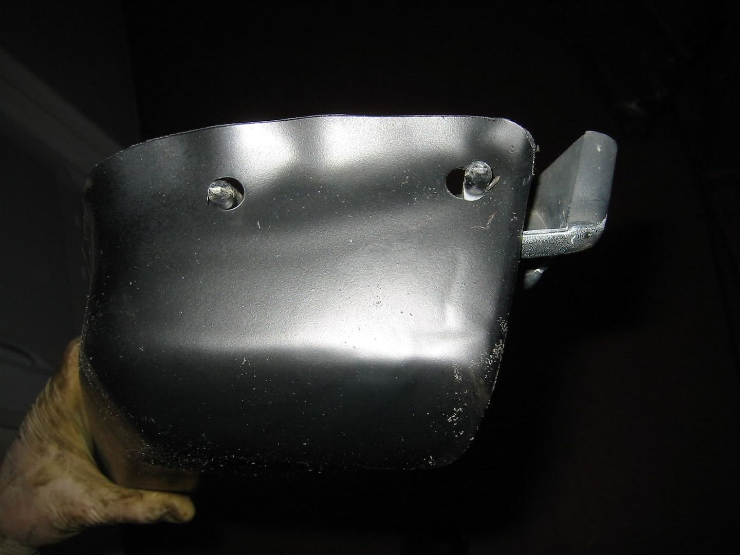

The holes at the top didn't line up when I first tried fitting the scoop to the vent so I had to open up one with a round file.
A bit wrinkly!!

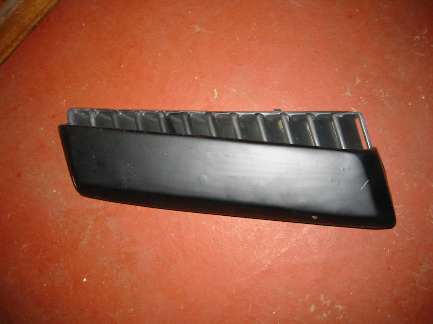

One thing I'm not sure about is that while the vent's vertical lines are not paralell, the scoops vertical lines are and this leads to a mis-match.

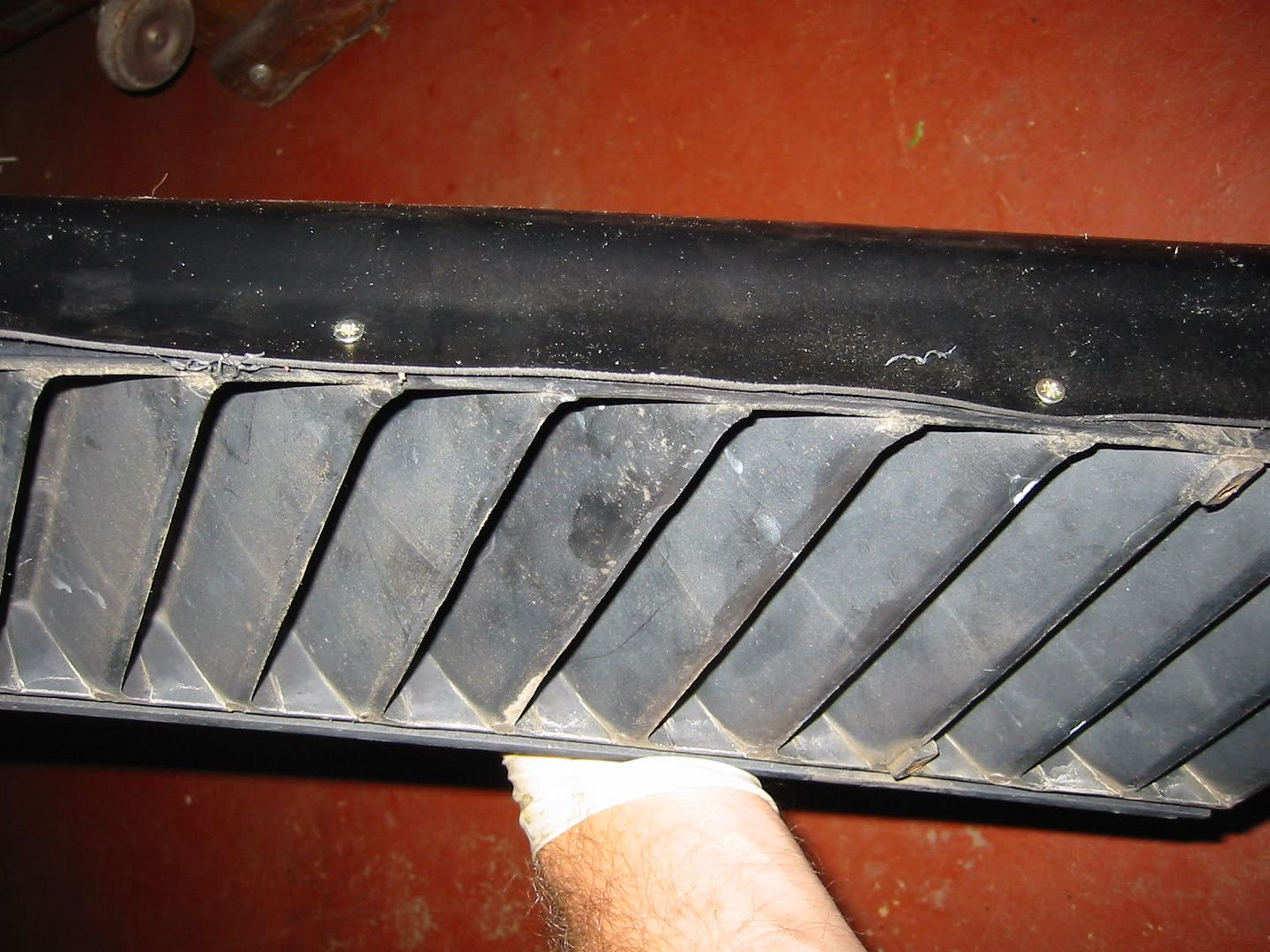

The kit comes with instructions, screws and white (!) tie-wraps.
The instructions suggest just one (white!) tie wrap will be enough to wrap around the bottom rung on the vent. I looked at this and realised that this part is probably going to be taking the most stress so I drilled an extra 3 holes and used 2 (black) tie-wraps for a neater finish.
I pre-drilled the vent (2mm) to help with the screws supplied with the kit.

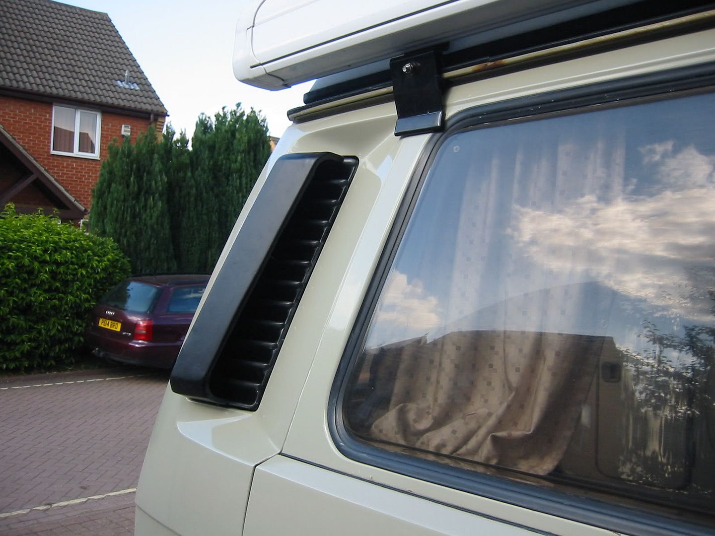

And then fitted it to the van...
I'm going to do some test runs with and without the scoop (I'll just remove the vent) to see what the difference is in temps. The next stage will include a couple of motorbike radiator cooling fans on the oil cooler connected up to a thermo switch to kick in at 95oC and cut out at 90oC or something around that.
Oh, you can only get one of the fixing screws back into the vent after installing the scoop.
I have seen some other scoops on vans and they are a better fit to the vent, i.e. they come right to the front of the vent opening but then you need to have 2 holes in the scoop to get the screw driver through and grommets to fill the holes. I might yet do this on mine.

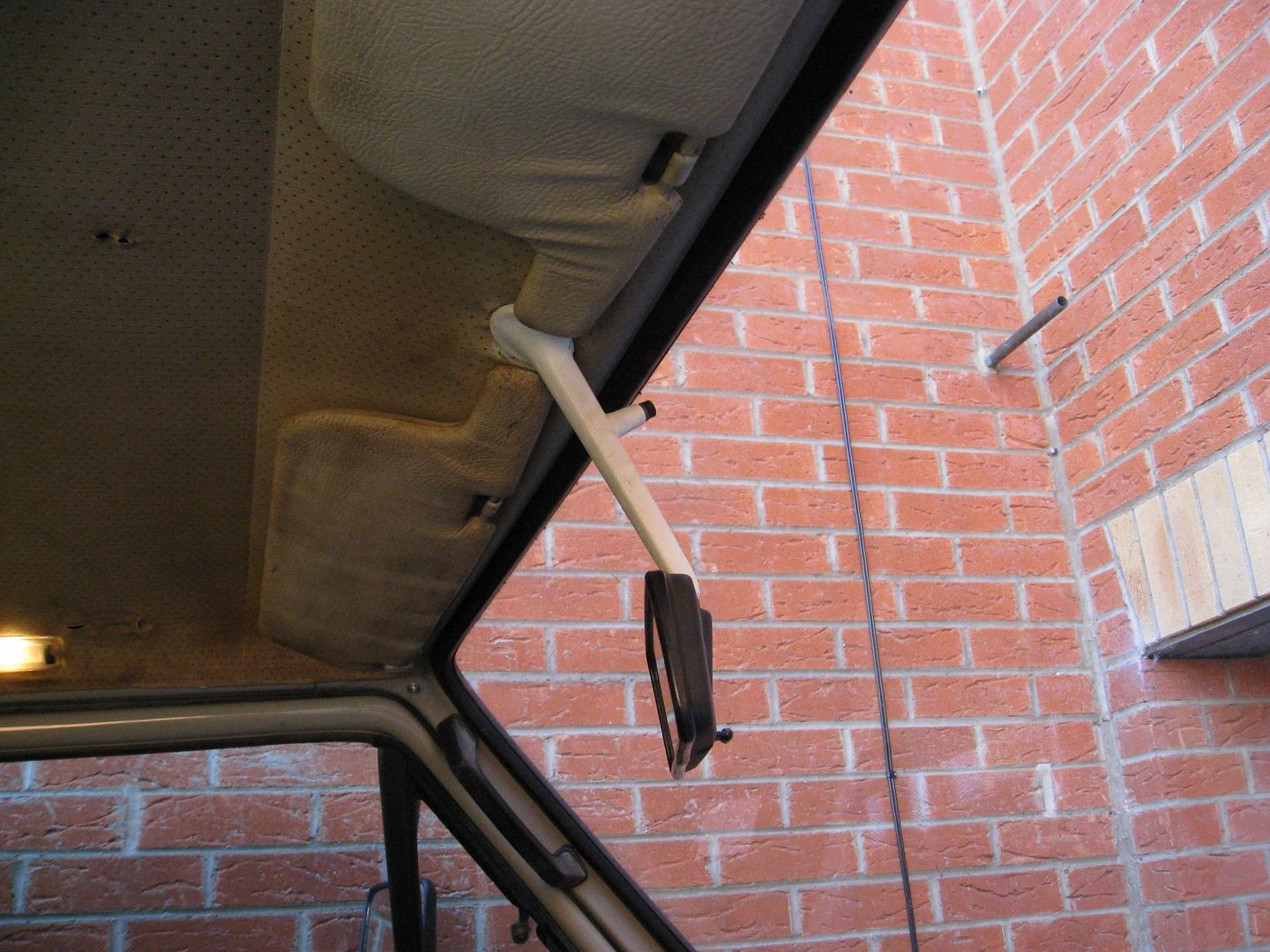

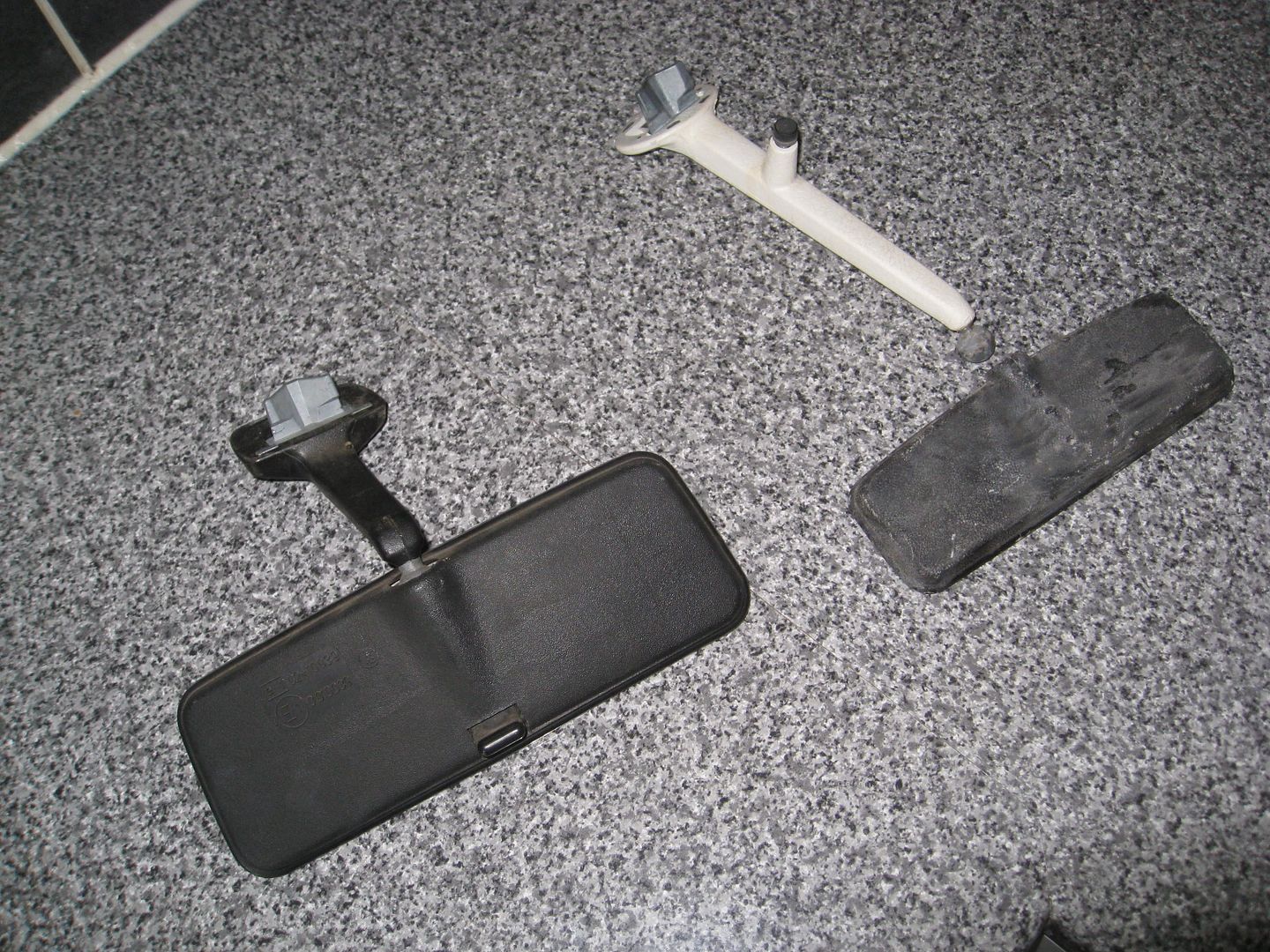

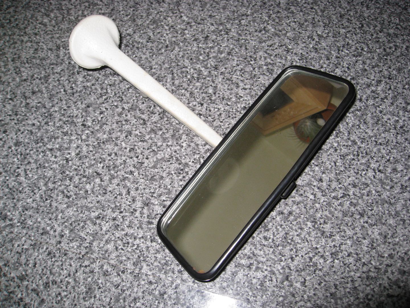

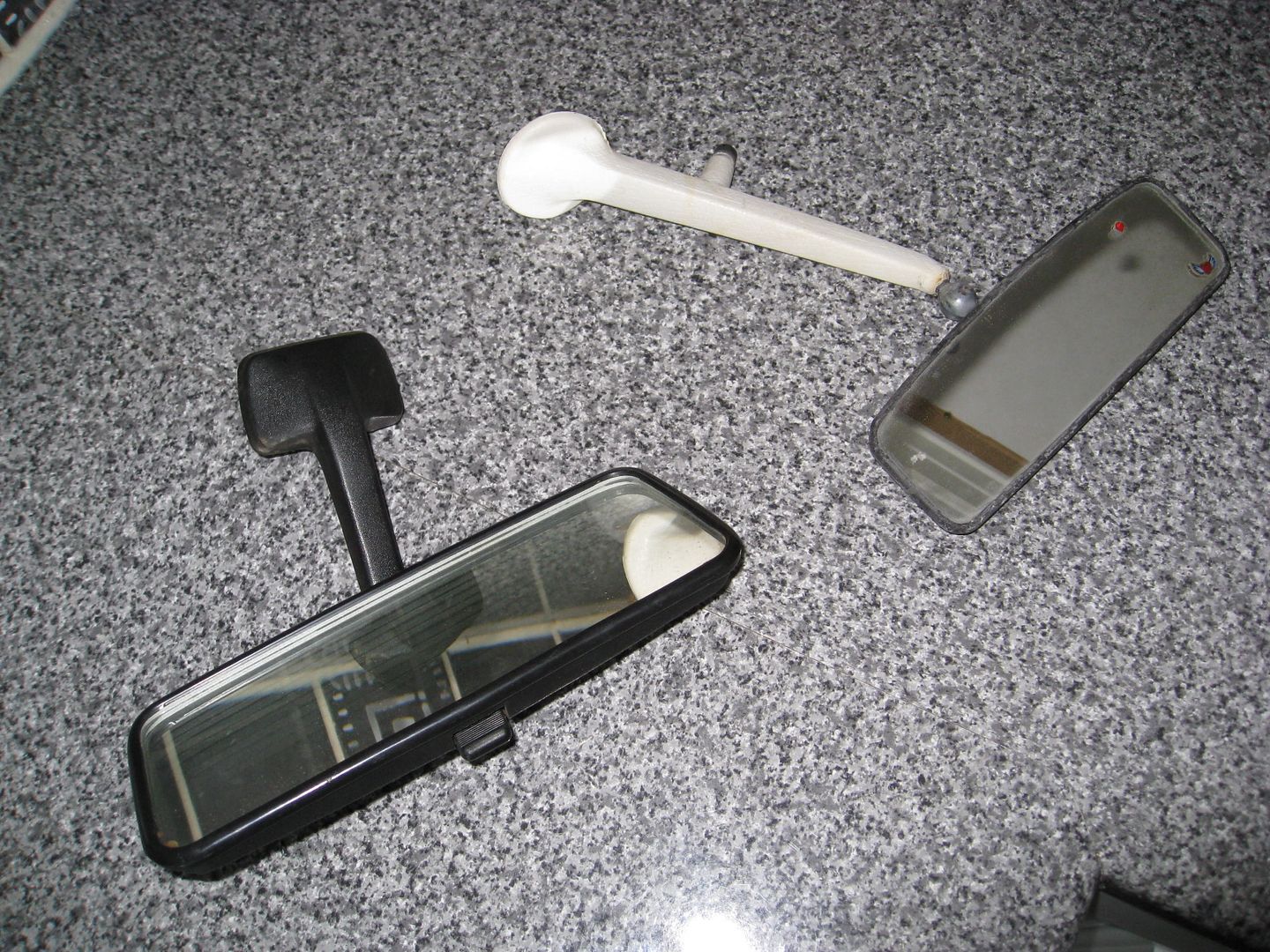

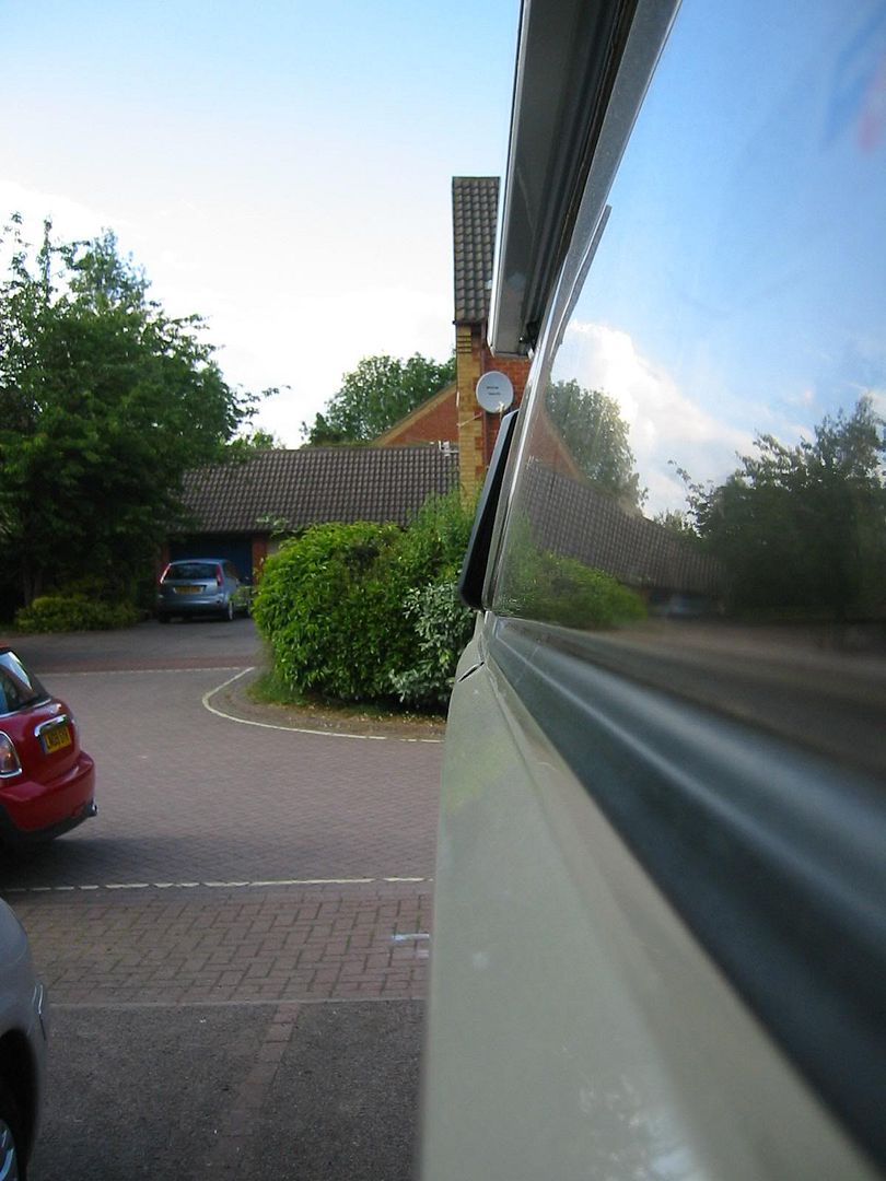

I also managed to find a 1968 only Bay window rear view mirror as ever since I installed the Westfalia rear roof storage cupboard, I've not been able to see out of the rear window properly! I wasn't sure about it to start off with as it sits right in the middle of the windscreen and I thought it would be a hazard rather than a help but I've found it to be quite the opposite. I can now see out the rear window very well and the mirror doesn't impede too much more than the standard position. I need to extend the support up to the windscreen to stop it from vibrating.
Some photos...
Both mirrors share the same ball/socket size so it's just a case of pulling the old one off and pushing the new one on.

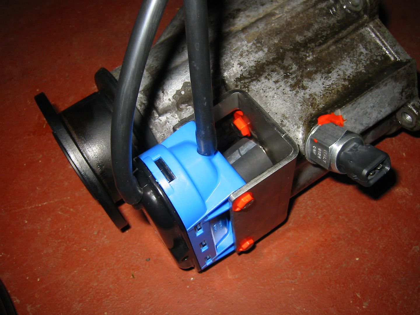

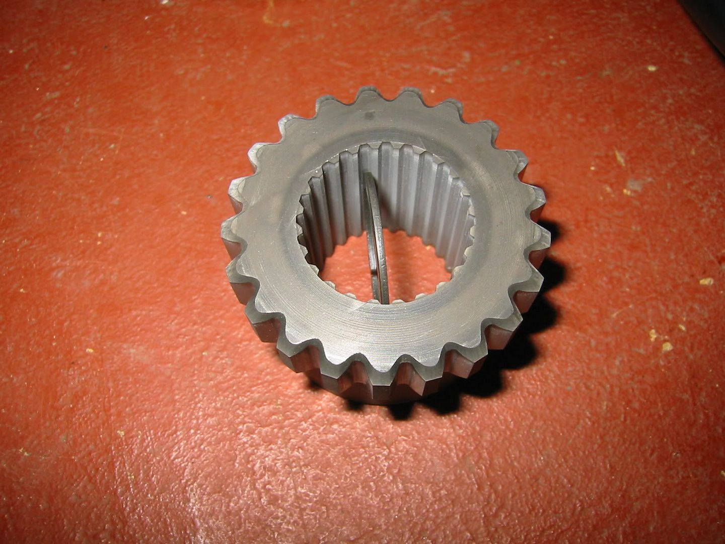

I have recently bought some parts from Busschmiede in Germany. After winning a decoupler (still can't believe that!), I took a look at their website and although it's in German, they have some very neat stuff on there for our vans.
I particularly liked the kit they sell for helping the TD engines which consists of a thermostat and radiator fan switch, both of which open and bring the fan in at lower temperatures. The thermostat opens at 80oC and the radiator fan switch operates at 80oC/85oC.
http://www.busschmiede.de/shop/T3-WASSER-KIT-fuer-TD-80-85-Thermosch-Thermostat-80
I'll be fitting these later on today and will report back about differences on how it runs re water temps.

SyncroGhia wrote:
An update today or yesterdays work.
A bit wrinkly!!
One thing I'm not sure about is that while the vent's vertical lines are not parallel, the scoops vertical lines are and this leads to a mismatch.
Some photos...

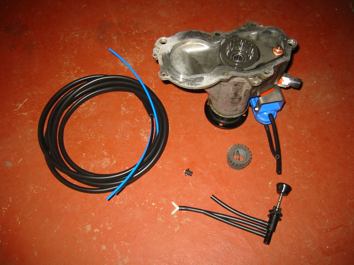

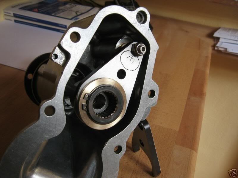

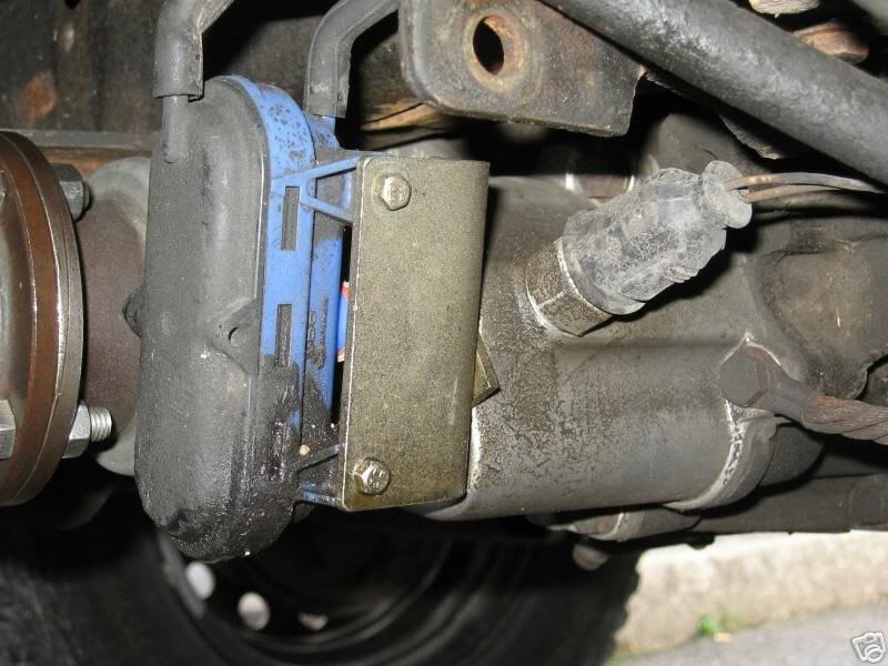

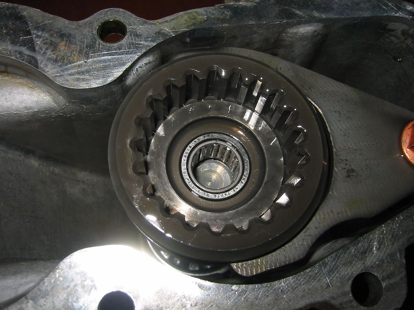

Just a few photos of the decoupler from Busschmiede. There have been a few discussions on here about the differences between decouplers on the market and I have a few photos of other decouples including the one I use on Limey so I thought I'd post them up here.
First the Busschmiede decoupler:
Now the decoupler which I have on Limey which is a Stefan unit which Syncro Services supply.
The only difference I've seen between the Busschmiede and Stefan decouplers is the design of the teeth for the gear to engage. The Busschmiede unit teeth are just chamfered off where as the Stefan unit teeth are specifically designed in a similar fashion to those on synchroniser slider rings.
Here is a unit which I've seen advertised in the U.S. which doesn't have a bearing or bush in the end of the output shaft which would support the shaft. This part comes up against the end of the pinion shaft so damage here is very serious.
