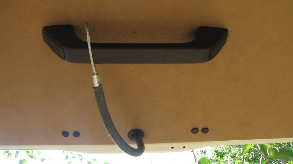

Okay, a new one because I recently redid my rear hatch release/handle and actually took a picture of it. It allows me to open AND close the rear hatch from the inside regardless of whether it's locked or not. The handle is screwed to some steel plates I mounted to the inside of the door. The latch release is simply 3/16" braided steel wire with some hose over it. Simple, clean, practical.
I also enjoy this thread and thought I'd rejuvenate it.

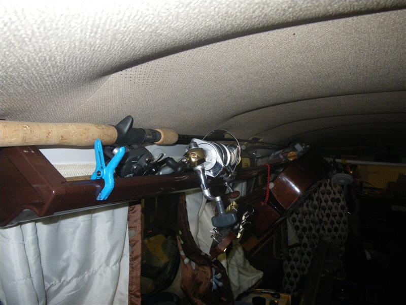

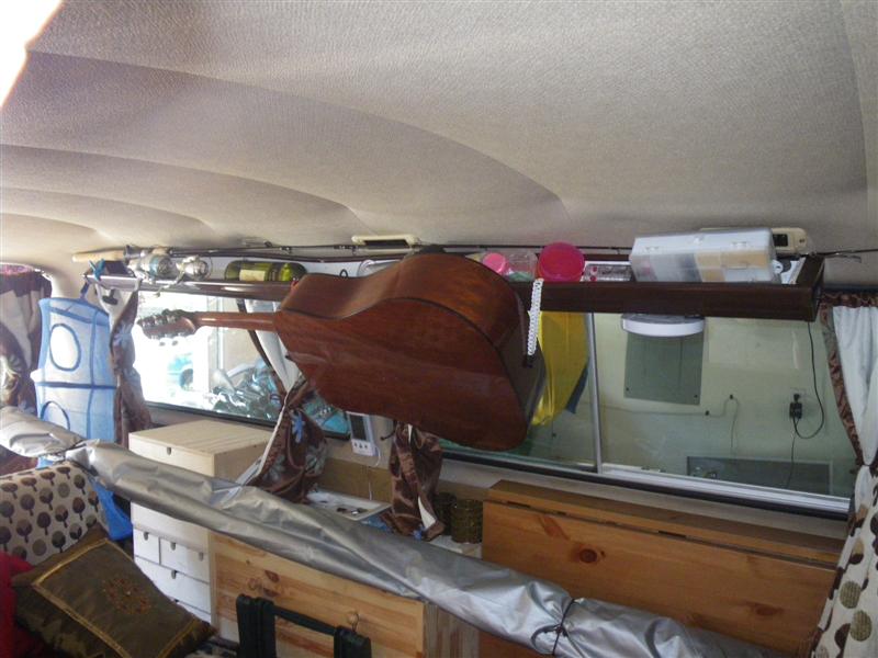

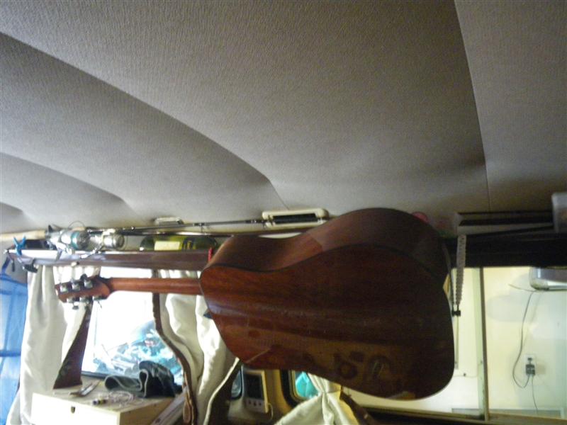

So I wanted to be able to carry my 3 fishing rods, tackle a few other items and the guitar of course high above everything. I wanted that "Gutter Storage" unit that a Westy has. So I fashioned my own. Super sturdy very practical.
Home Depot:
1 10' Length of Brown Vinyl Gutter $4.58
2 end caps $6.78
4 3/4' self tap sheet metal screws
4 1 1/2' washers
I used about 6' of gutter to achieve this. I added the end caps and screwed the thing in just below the vents. I used the Screws and washers to hold it in place. I used some nylon bracelets to hold my guitar. The gutter has a lip in side that holds the guitar straps. It's almost crazy how great this worked out. It is bullet proof. Best mod I ever did.

As one who also frequently travels with a guitar (or usually two...) I'd be afraid of too much heat affecting the ol' axe when it's hanging in the window like that, out of a case, not to mention the "steal me" factor. Obviously this doesn't bother you. Am I paranoid?

Sweet idea. Been looking for a way to get the Git Fid out of the way. I have thought of a hangar on the pop top push up bar for storing while at camp. This really gets it out of the way. Does it spoil the view for the rear passengers?

This is truly an awesome upgrade. Yes the guit is in the window but when we travel, I close the curtains on that side to protect it from the sun which in Oregon is a bit rare. The Guitar Ganking factor? Very good point, did not really consider it but as it is a Fender low ender, and hanging in plain site might say "I am not worth that much so leave me alone A Hole!!" One can hope it goes that way. As for the View Carter,,, No the little dogs don't mind it blocking their view.
Do this ,, loads of extra storage and note the Bottle of Vino???

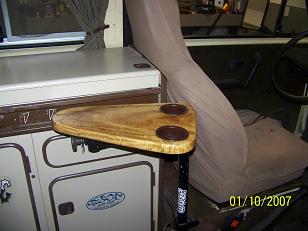

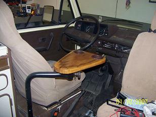

My Myrtlewood armrest/cup holder table.
Then folds out of the way.
Also, makes a great step for the upper bunk.[/img][/img]

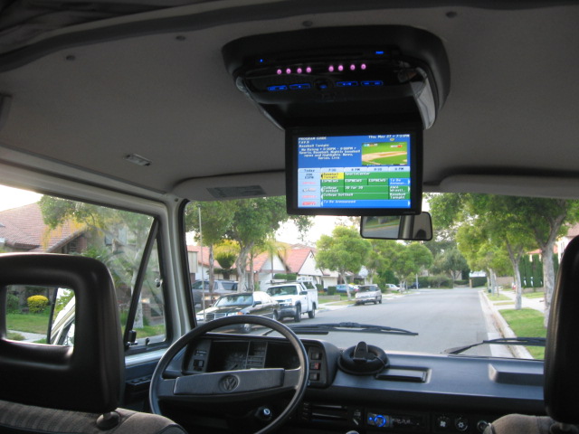

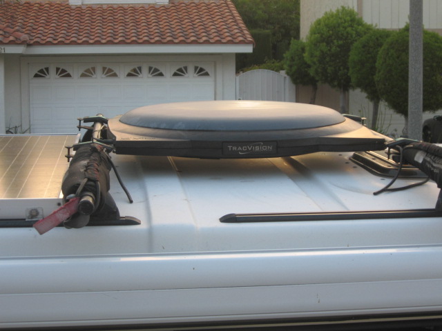

satelite

What make is that dvd system? any more details on the system install and how good it works? me and the wife want to install a setup like that.

dvd player is Alpine PKG-RSE2 it is pricey but one of the best period. The picture quality is the best. The satelite system is the older KVH A5 which was pretty easy to install. look under satelite under the forums and i've posted some pictures on the install. if you have further questions u can pm me. I have two extra odyssey battery, about 165 amp hours total because it does use some wattage. the system works awesome, the satelite will track its signal by itself. i rarely use the dvd player since i have the satelite system and if you have direct tv it's only $6 a month.
