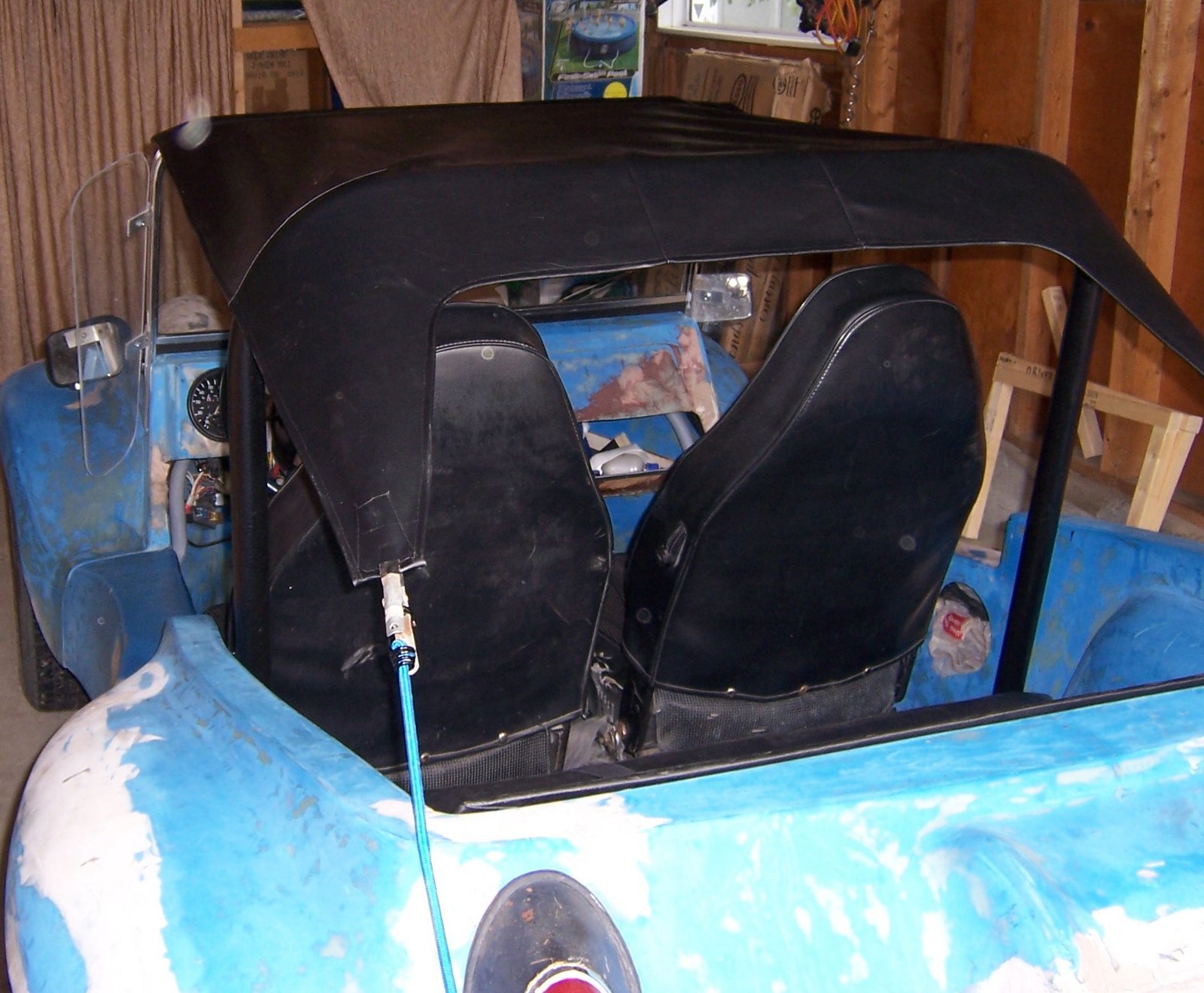

The finished top:

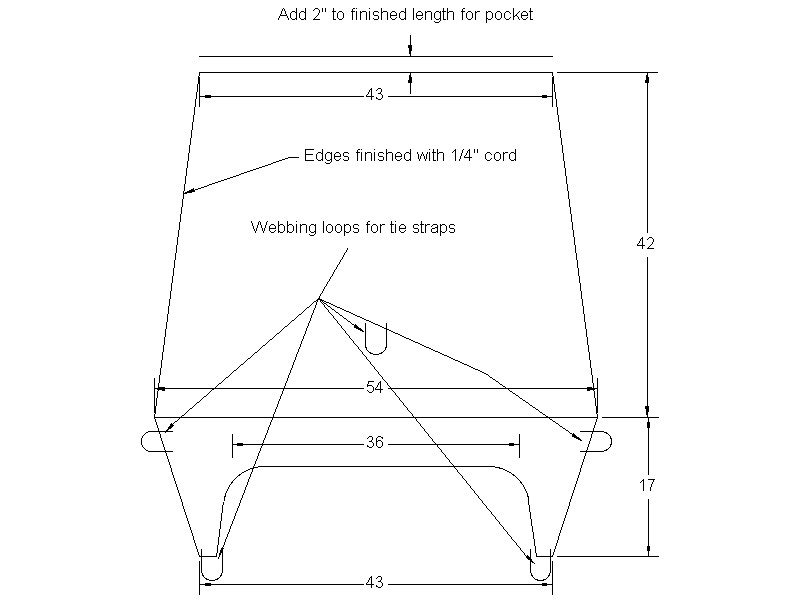

Measure. My rough measurements were as follows but yours will probably be different......
Cut to size. Leave 2" extra length at the front to form the pocket for the insert strip and if in doubt, leave oversize.
Fold over the 2" at the front edge to form a pocket and sew this edge, starting and stopping the seam about 2" from the sides. The pocket does not extend right to the outside edges. The insert strip is only as long as the straight part of the windshield frame, the outside ends where the top curves down around the frame are held down by a snap fastener.

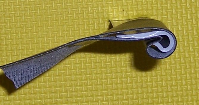

Insert the plastic strip in the pocket and fit the top on the car. I found that the plastic strip was very stiff and hard to get into the groove in the windshield and I use a cheap plastic lever action C-clamp to force the strip into place.
How the insert strip fits into the pocket:
It is supposed to be sewn into place but there is no way I could get a needle thorough it.

The first fitting (note the bungee cord/spring clamps holding the back in place):
Mark where material has to be removed to make it lie flat at the roll bar, and make this tuck point. In my case the required V-shaped cutout was about 6" long.
There will initially be wrinkles at the ends of these tuck seams but they will flatten out over time. Alternatively, you could make the entire back edge as a separate piece so there is one long seam across the roll bar. There should then be no wrinkles.
Replace on the car for a second fitting. I found that I needed two more tucks above the rear window opening as it was baggy here because the top narrows toward the rear.
The second fitting:
When satisfied with the fit, sew in the edge cord all around the top except at the front, then add the webbing loops or tie straps for attaching to the body. I have attachment points pulling the sides down beside the rollbar as well as the ones at the rear. I also found that adding a tensioning cord in the centre of the top pulling back to the rollbar really reduced the tendency to flap at speed. The downside of this is that it makes a visible wrinkle in the middle of the top.
