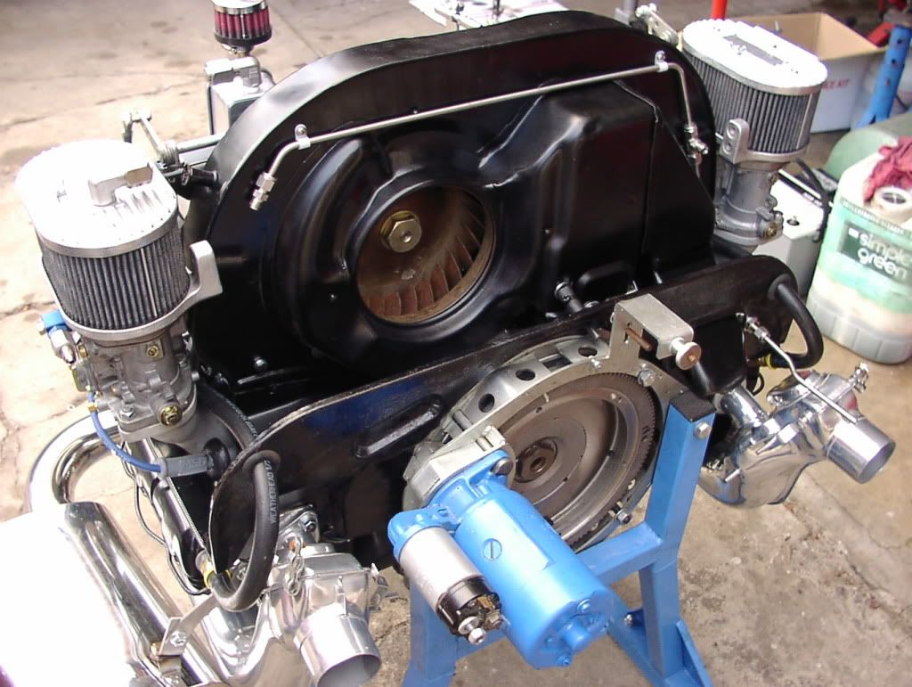

Here's my two cents...
I took "Lost In Baja's" post one step further on my 2007cc. In addition to adding 2/3 of one stainless steel Scotch Brite Scowering Pad to help collet the oil vapors to prevent potential clogging of my K&N filter, I drilled & tapped another intake fitting to the lower end of the box. Now, the oil vapors enter the lower third of the box, the full oil collection benefit of the breather is realized, and the K&N Filter shouldn't wet-out. The new intake fitting is tapped high enough to prevent oil backflowing into the valve covers when filling the case with oil. Seal it all up with some high-temp silicone sealer on both sides of the face plate rubber gasket and the pedistal gasket, and it'll stay nice, dry, & clean.
Enjoy!

It would sure suck big time IF a chunk of those scrubbing pads fell into the engine. I would at least add a screen over the large hole leading into the engine or would the stock louvered part do the trick ??

You're looking at 2/3 of one pad that has been stretched and puffed up. The pad is extremely tough and cutting 2/3 of it off was a bitch, so I'm confident it won't separate.

Nice looking engine.

Thanks for the compliment Glenn. You helped me with the parts to rebuild my 019.

I added a fitting to the back like this guy. I used one of the bottom fittings for a return like to the fuel pump block off. I filled the box with layers of steel screen material to help slow down the oil mist and help it to condense and fall back into the box/motor.

I TIG welded my CB breather box directly to the alternator stand. No leaks Smile I also enlarged the tapped holes to 3/8 instead of 1/4 pipe. I stuffed three copper cleaning pads inside. Finally, gloss black powder coated the whole shabang.

Just uploaded one:
The bottom is plumbed to the fuel pump block off with 3/8 fittings.
The top fittings are still 1/4 pipe. This is working on my 13.1:1 2275.
