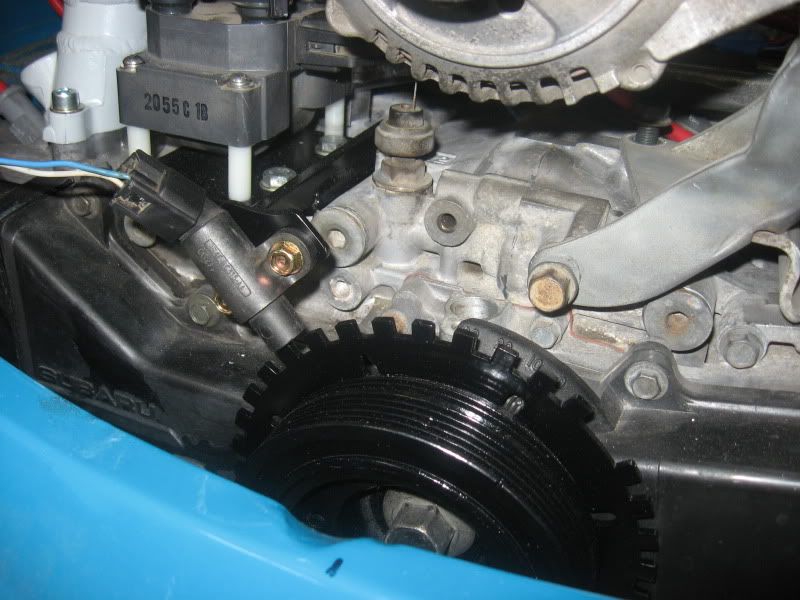

however, I don't disagree with anything you've said... I myself would like more info on the ford crank trigger trick. I do prefer to run aircooled in my street cars, and this poll aside, have no real love for water cooled other than offroad abuse-ability. Please do post the ford/chevy stuff you mentioned. I made most of my efi system myself, but would still like to convert over to a crank trigger rather than the hall-effect sensor Im using currently Applause
Here's the site for the crank trigger;
http://lowbugget.com/main_page.html
