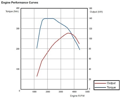

I would like to see a torque/hp graph of the Sub diesel if anyone knows of one handy. From what I gather, in stock form it puts out a fairly impressive 150bhp and 258ft-lbs of torque. That's an extra 60hp and 103ft-lbs over the early TDIs that fit under the engine lid. The peak torque is available at 1,800 rpms. The engine may well be able to be mated to the trans using existing conversion parts. Those are a few good reasons.
I am a high-functioning autistic into VW diesels and Vanagons along with other things that are unrelated to this site.
syncroserge
Joined: November 26, 2005
Posts: 571
Location: Okotos, Alberta, Canada
syncroserge is offline
PostPosted: Tue Nov 30, 2010 3:47 pm    Post subject: Reply with quote
http://www.thesamba.com/vw/forum/viewtopic.php?t=391279
'bout halfway down the page..

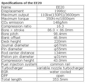

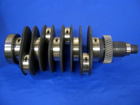

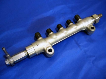

Here are more details about the EE20 engine :
Very interesting link (in russian) content nice pics and details : http://www.google.com/imgres?imgurl=http://www.rea...lAf17Z3_CQ
GSB
conversions: www.boxeer.com Common rail TDI and NOW PDK transmissions!!
travel pictures:
http://instagram.com/crepeattack/
- the Pastis build: http://www.thesamba.com/vw/forum/viewtopic.php?t=434656&highlight=subaru+diesel
