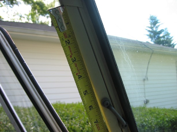

I haven't been able to find anything on placement of the cot brackets....measurements from the dash up or ceiling down?

PostPosted: Fri May 10, 2013 10:31 pm    Post subject: Reply with quote
In my gallery--oldest pictures uploaded.
Somewhere the measurements are in a thread too.

From this Thread
http://www.thesamba.com/vw/forum/viewtopic.php?t=5...childs+cot
Major Woody wrote:
Here are the two pictures of the footman loops for the cot poles (with measurements) that I promised to take back in mid-December.
Here is the rear. Measurement is 5.5" down from the spot welded joint. Photo is of the passenger side.
Here is the front. Measurement is 6" down from the spot welded joint. It is mounted at a 45 degree angle. Photo is of the driver side.
