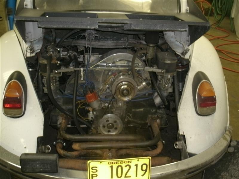

Hi Volks, I made some moves and now German Perfection owns the "Davesport" Bug!!! I think this is the coolest Bug we could have found and now it is back in Denver!! It does work really well, and we took it for some runs in Nevada and were really pleased. the previous owner took great care of this Bug and kept it in operating condition, including making some improvements. We are planning a thorough clean up, a full rewire, and some other things. Progress will be put in this thread! I'm going to start a shop thread soon. Enjoy the pics for now!
Full Specs:
2016cc type 1 motor
dual 44 webers
Bus 091 box custom gears, custom nose cone with Power take-off
Front a-arms with axles, look to be possibly MK2 VW
Datsun front differential
"slip-yoke" between the front seats for rwd or awd
fiberglass front end, fiberglass w-decklid
Beard seats
custom coil over suspension front and rear
skidplates and tow hooks

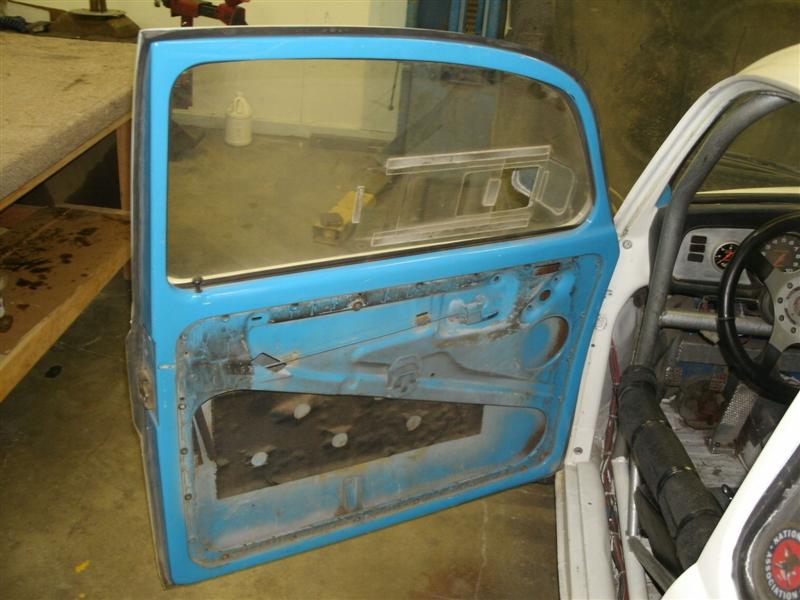

in the pic that shows the interior and roll bar- the stock holes in the passenger door show an odd striped orange glow... are the exterior door skins fiberglass as well?
just wondered...
nice rig... looks like it deserves to be raced.
well done!
Ian
Joined: August 28, 2002
Posts: 4958
Location: 713
Ian is offline
PostPosted: Thu Jan 06, 2011 4:17 pm    Post subject: Reply with quote
nah, there are some safety triangles stuffed in the doors...the doors are OG metal..and remove with quick removable door pins
Got any pics and info on these? It's been a hot topic lately.
Kyle
Ian
Posts: 4958
Location: 713
Ian is offline
PostPosted: Thu Jan 06, 2011 5:57 pm    Post subject: Reply with quote
czech it out!!
1/2 the hinge stays on the body, 1/2 on the door
the pins are really cool, one pin has only 1/2 a tang for the lower hinge because it's so close to the body, the pins have a button on top that you push and a little ball on the bottom moves and then you can take it out of the hinge, takes me about 1 minute for on/off, very quick and simple
one cool blue door Cool
hope that helps!!

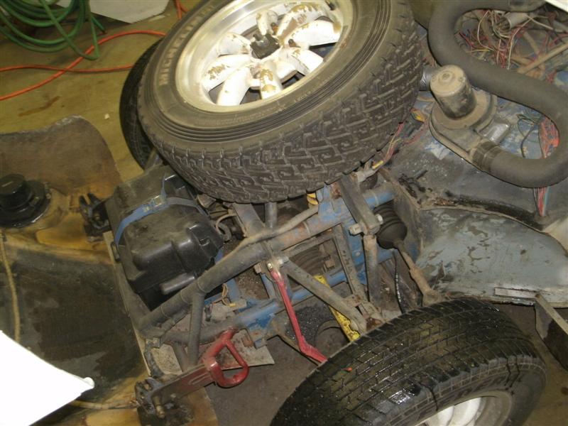

Awesome build!! Dying to see the pics of how the AWD was done...

NOW THIS IS THE COOLEST thing i've seen in awhile... I'd lilke to see how they did the transfer case to drive the front axle. Makes me want to build one.... thats a very cool car. nice find.
