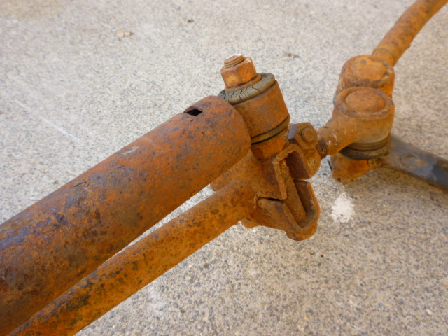

PostPosted: Mon Jan 17, 2011 6:38 pm    Post subject: Reply with quote
Here are some pics of the steering dampener kit I found on the 55 beetle front beam. The parts look rustier than they really are thanks to the morning light.
This end is attached to the tie rod
This is the clamp that attaches to the beam
It looks like a nice set up, perhaps too nice for a home job. My guess would be factory accessorie or after market kit.

PostPosted: Sat Jan 22, 2011 9:07 am    Post subject: Reply with quote
I just picked up a '54 Beetle and theres some rust thru on the rockers so the car itself is no good, what parts should I save? ...
I'm guessing you aren't from the North East? I've never seen a beam that was beyond saving, I've got a stack of em with holes, if I can't put my fist thru it I keep them, I bet its worth less than $2 scrap
cool damper by the way, I think the factory accessory type had a new style casting for the steering arm where the damper attatched, I've never felt the need for one on my older cars, maybe if you drove on a lot of rutted dirt roads they helped more
