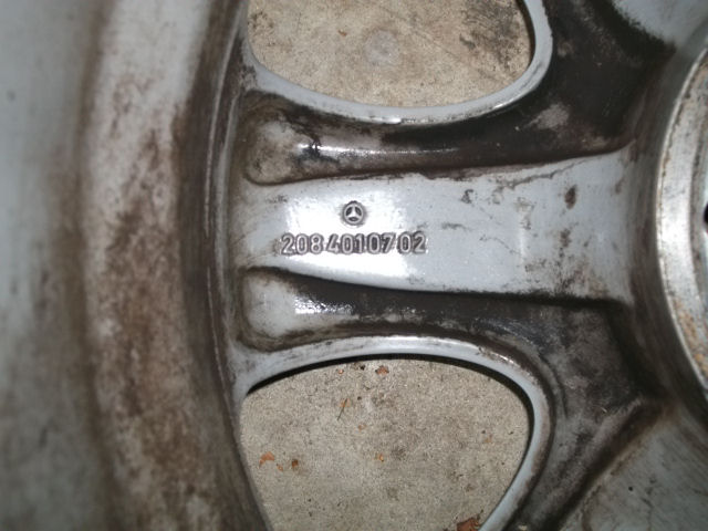

I sort of agree with you on the looks. I picked up a set of four 2002 CLK wheel and I think they look a little better. All four has curb rash and its $100 for all four. 16 X 7 ET 37, made by Ronal.

Hmm, any chance to take a look on the backside to share the part # and other markings ?
TIA,
Jim
Are you talking about the wheels that stevey88 posted?
If so, they are a 16x7 ET37 from a '01-'03 CLK320 part number 208 401 0702. See my post above for fitment issues on a Syncro.
Don't confuse them for the nearly identical looking 17x7.5 version from the '01 SLK.
