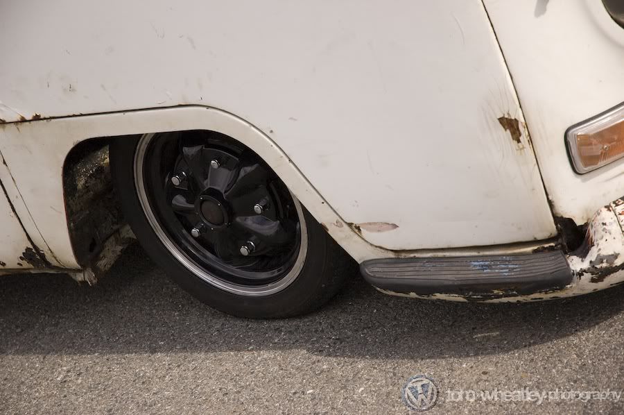

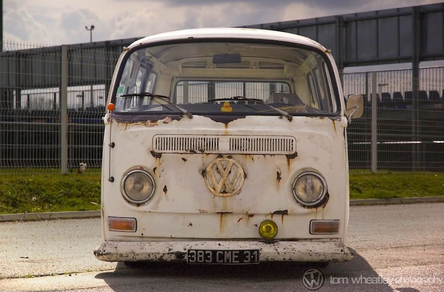

I'm Boris, one of the BlackHands guys, from the sunny south of France, and this is my so sweeeet ride, 1970 8 passengers, before I started to work on her, one month ago...
it had a middle drop set up I did one year ago, but still to high for me...so here is the build up:
for the front, I built a 2" raised, 4.5" narrowed balljoint beam (with OG bearings!), and 2.5"BJ drop spindles.
For the rear, I was inspired by KCW and the guys from Slamwerks Wink , so I did a bug gearbox conversion...1302 IRS gearbox, with splitbus nosecone, OG axles, and big new boxed chassis section to allow a full travel for axles and arms with Creative adjustable springplates
and this is the final result, this weekend at a local swapmeet (Thanks to Tom, Mika and Mayane for the great pics Wink )

Heyyy Boris!
You already know what I think of your bay! It was kinda s*** before you slammed it! It's just so much better now! Very Happy

Looks great. Is the camber adjustable on the rear setup?

bobo31
Joined: November 01, 2008
Posts: 50
Location: Toulouse, FRANCE
bobo31 is offline
PostPosted: Mon Mar 14, 2011 12:38 pm    Post subject: Reply with quote
VWsArent4Hippies wrote:
Shit's bad!
Confused
that's a real compliment from you, your (first Wink ) green bus stuck me when you did it!!!
and no, camber is reduced thanks to the bug box design, and axles are horizontal...

Props to your fabrication skills but it looks like that camber is going to kill your rear tires in a hurry.
Nah, that camber's not bad at all. Looks about like a beetle at 1 spline. Tow kills tires wayy faster than camber.
