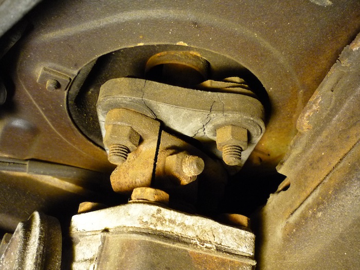

I've had a new replacement sitting in my to-do pile for awhile. Got it from "Wagen Works". I'll be replacing it sometime soon, but thought I'd ask for some feedback in advance. '78 Westy
Is this as easy to do as it looks?
Bentley fig. 9-12 (Front Axle) shows there to a lockplate on the coupling flange, whereas you can see on mine, there is not. Anyone know if mine's OK without it, i.e. did some come without it?
Thanks for looking, and for any input.

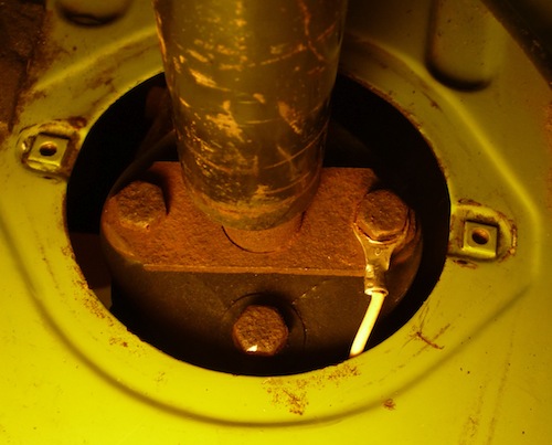

Mal volent; I started off with your technique of doing it from the bottom only, but when it was time to pull the bolts up and drop the new rubber in, I couldn't see how to do that without working from the top. So I pulled the carpet back and removed the 2 screws which hold the steering wheel column base cover on, and pulled it up and out of the way. Then I finished the job from the top.
The ground wire was broken long before I came along, and yet my horn has been working just dandy. Of course I replaced it with a new wire, but how could it have been working without one? Always a new mystery.
Old coupling before removal. You can just see the old ground terminal, minus its wire.

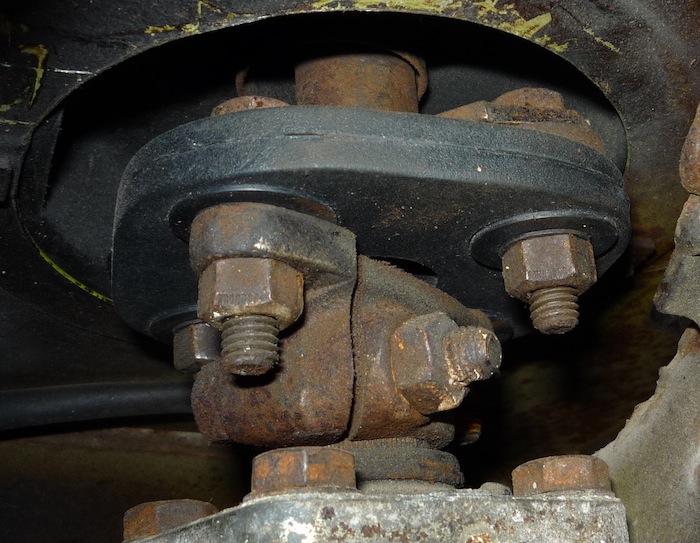

Old parts;
Old & New;
New parts installed;
And the new coupling from the bottom;

Here you go. 6 months to the day later. Glad you asked, as it was easy enough to get down under the bus and take a look. It's just fine & looks good as new. I believe the non-German replacement part I bought is going to be just fine, but will check again from time to time, and if I can remember, I'll report back. Like I said, it's important that this particular part does not fail, so cheaper versions may not be a very good idea. Listening to German Supply Scott is a good practice. Wink
